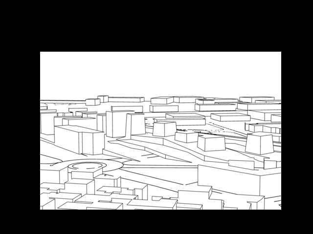

arch15 Posted February 25, 2011 Posted February 25, 2011 Hi again, it took me a while to get back to you, sorry. But here is the file finally and a test print using the hidden line contours renderer. Actually I prefer this way to get the white model but as you can see from the test print not all contours of the objects will show, melting them together very often, which just looks wrong specially for the landscape. I don't know if it is possible to avoid that somehow so I get a similar result as in the reference picture I attach along. Again, working with the ink 'n paint will just give me a blank sheet... Any suggestions there? I work with 3d max 2009 by the way and the drawing was imported from autocad. arch15_test.zip Quote
Cad64 Posted February 26, 2011 Posted February 26, 2011 Well, I don't really know why you're getting a blank screen? It renders fine for me on Max 2011. In order to get all the contours of the objects to show, you need to increase your sampling quality. In your "Render Settings" dialog, "Renderer" tab, under "Sampling Quality" set "Samples per Pixel" to Minimum 4 Maximum 16 and for "Filter" choose "Mitchell". Or, if you really want to dial it in, set Minimum to 16 and Maximum to 64. Quote
arch15 Posted March 1, 2011 Posted March 1, 2011 Thanks for the hints. I figure I must have my 2009 version configured differently or something, because all I get is the blank page. Well I guess, I might have to check on this on a new thread. Anyway I changed the render settings. But while the contours are much precise and sharp now (thanks for that), some of them still won't show at all, so the volumes keep melting together (see attached image). Something tells me it has something to do with the shading since the melting happens there when the ground and the volumes or volumes sides next to each other have the same colour. I tried to assign materials with different colours and so on but it won't have any effect on the rendered image obviously and even unchecking shadows everywhere in the settings won't get me any further. Other suggestions there? Quote
Cad64 Posted March 1, 2011 Posted March 1, 2011 I haven't got time to read through everything in this pdf, but take a look. I think it addresses the problem you're having: http://au.autodesk.com/?autodownload=../orig/class_questions/thread__872/DV214-1.pdf&mystem=../orig/class_questions/thread__872/DV214-1.pdf Quote
arch15 Posted March 3, 2011 Posted March 3, 2011 YES! YES! YES! It worked! Thank you sooo much! I followed that one tiny step from your pdf and the contours showed. So I just had to go to camera effects under the renderer tab in the render settings and adjust the settings for the contour contrast shader. I assigned the shader to a sample slot on the material editor and changed the value of the z-step threshold from 1000 (!) to 5 and I finally got it. YES! I also figured why I got the blank page for the ink'n paint override. From the approaches you suggested to get the black and white image I had tried the one using the hidden line contours renderer first. So when I moved on to the ink'n paint override I forgot to change the renderer back to the normal mental ray.... Well there is the prove, we are all just one small adjustment away from making things work! Thanks again for your help! Quote

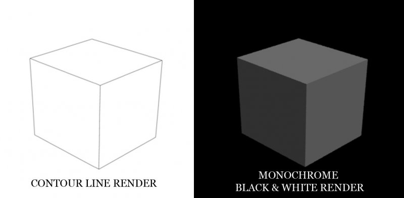

NotTheGuest Posted May 27, 2011 Posted May 27, 2011 Kinda late here, but a really easy way to get a black and white image in the 3ds max renderer is: 1. Hit f9 to render 2. Press the monochrome button (to the right of the RGB channel selector) 2. Press the copy image button (next to the save image button) 3. Open up Microsoft Paint (or whatever image editing program you have at your disposal) 4. Press ctrl. + v to paste in your black and white image. Bam, black and white image. Quote
Cad64 Posted May 27, 2011 Posted May 27, 2011 Well, that's not really what the OP was trying to do. I know the title of this thread says "black and white image" but he wasn't really trying to get a black and white render. He was trying to get a contour line render. Quote
