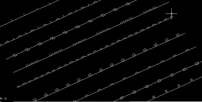

Is it possible to post a screen shot of one of the linetypes? Someone may have different ideas on how to create the effect you desire.
Of course. Here are just 9 of over hundred linetypes...
As they are quite complex linetypes I will agree with Tiger and suggest e-transmit as the best option.
I would have probably done those linetypes with a block and Measure.
