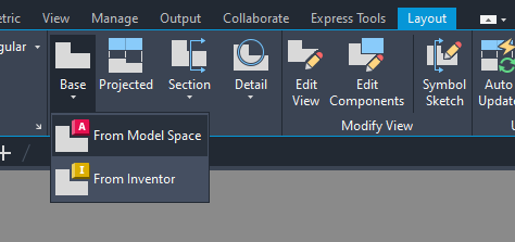

How to edit a layout after getting it from the 3D model.
I got a layout from a 3D model (screenshot 1) and now I need to edit it and delete some elements because I need to copy it into another layout, but it cannot be edited or copied; it just does not get selected (photo 2), maybe because it is still linked to the 3D model. How do I get rid of that link and edit it properly?

You get a Layout but no 3d? Just a guess: try to double-click a 2d representation -it should activate the viewport, if there is one- and next try to copy-paste.
It would help us to have a dwg file to play with.

I have a 3d model, and I took a layout from it, using a method on a screenshot 1, but I cannot edit it in any way :(

It's difficult to understand the problem from those screenshots. Can you provide a dwg file and more information about what you did and what you're trying to do?

I created a layout from my 3D model by clicking "Layout" -> "Base" -> "From Model Space."Screenshot_4.png.a74dddb0b26678dce98f2446f797c886.png
Now, I am trying to copy this layout to another DWG file, but I cannot copy it in any way—it just cannot be selected. Also, I can't edit it, such as deleting some parts on the layout layer.
Autocad Help.dwg

As far as I know, you cannot copy the layout. However, you can copy the 3D object in the model tab to another DWG file and then use the layout/viewbase again.
