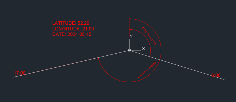

Hello,
I would like to select sun azimuth by block grip on my drawing.
1. I created a block with two grips (attached DWG)
2. LISP definition that gives an array of hour:minute and azimuth (radians).
So I need to update the value of attribute TIME1 and TIME2 when my grip changes. My problem can be probably solved by reactor. There is also a problem that the sun azimuth is defined from the north. Angle for grips in my block are defined in different way so i need to recalculate my azimuths.
I appreciate any responce.
Greetings
Marcin
