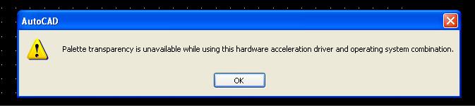

how can i change my hardware accelerator
Maybe...
3Dconfig > Manual Tune > Enable Hardware Acceleration (uncheck)
You may want to weigh value of palette transparency vs hardware accleration. We hve the same issue in our shop and many have chosen hardware acceleration.
You can check out the AutoCAD Graphic Hardware List to see if there is an update for you card.
