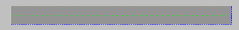

I have a problem with a lisp
Its a modified lee mac lisp for a double decade and a hatch in the middle of it
My problem is that i want a solid hatch with a 40 fade but ive try a lot of things and none of its works, my hatch got no fade
Here's the code

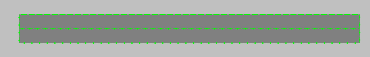

Im also wondering if its possible to change the line around the hatch , actualy the lisp do this when i use the command on the middle line
And the perfect way i wan't this lisp is like this (40% fade on the hatch and i would like the line around the hatch always be like this and not like the middle line
I don't know if all of this is possible, i'm using autocad LT 2024
I'm sorry for my bad english and i hope its understandable
Thank you for reading me and thank you for your help !
