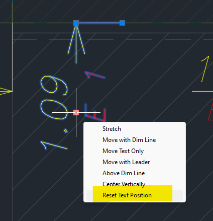

I’m looking for some help with creating an AutoLISP program. Specifically, I need a script that can reset the text position of multiple selected dimension lines, processing them one at a time. This would greatly streamline my workflow, and I’d really appreciate any guidance or sample code you could provide.
When doing this manually:

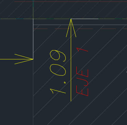

Dimension that was edited returns to original design:
Here is an approach but I still can't get the right command:

No need to use autolisp code. You can try this : Select dimension - DIMEDIT - Home .
thank you very much :)
