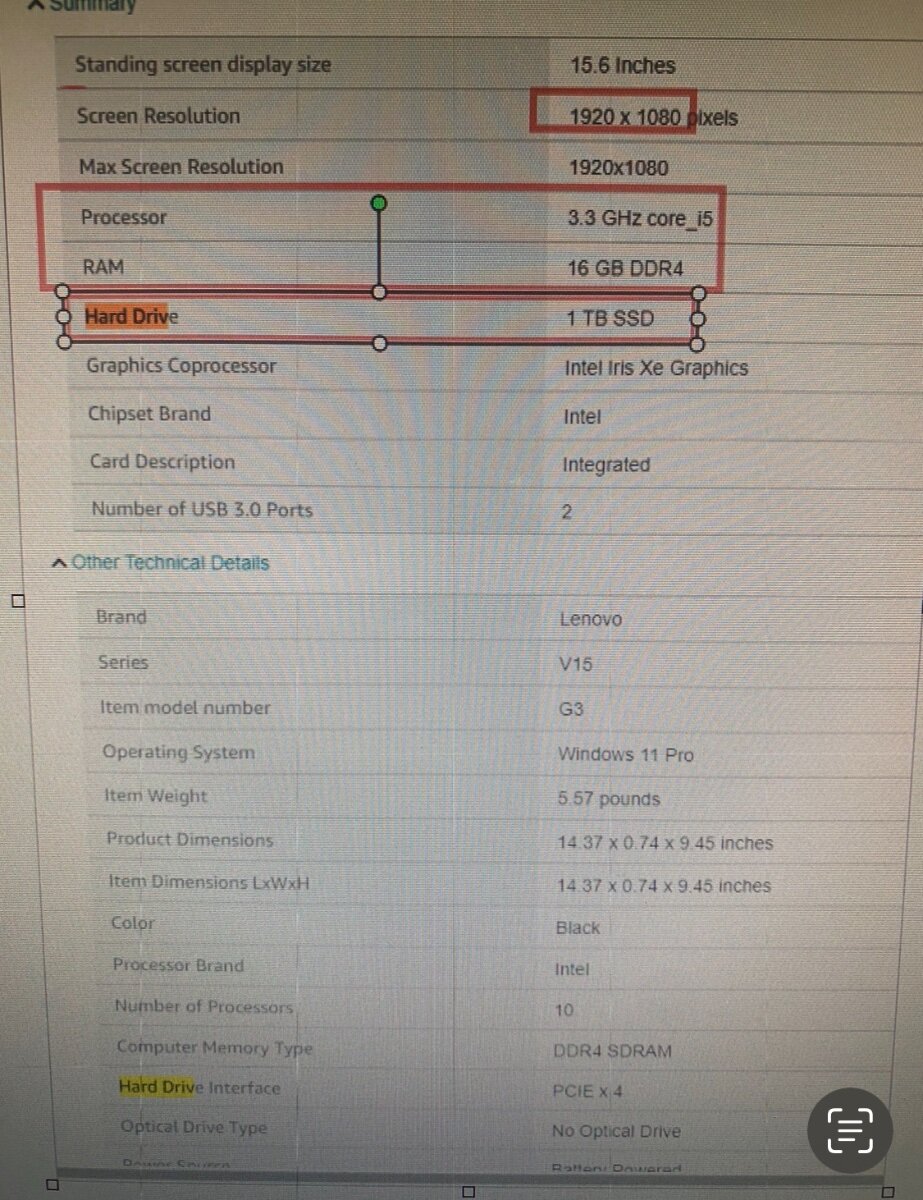

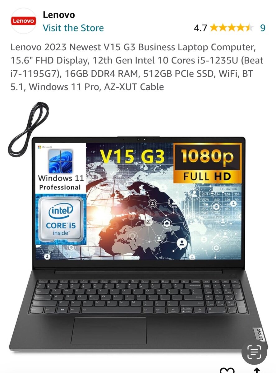

Can this Laptop run 3D AutoCAD? I compared the computer specs from Autodesk.  The processor and graphics and RAM size should be enough.  Auto desk required 64Bit  window 11.  This one said pro 64 which I assumed it’s ok?  My worry is The graphics card on this one is Intel iris Xe graphic which I read on Autodesk website it might crash or freeze. I hope I can try if it doesn’t work then return if no restocking fee.  I just want something that can do 3D AutoCad that is not over $700-$800.  Anyone has suggestions on good laptops that you used that are not too expensive? Can you share the model?   Thank you
Go a I7 and look for say a NVIDIA graphics card, maybe look at a AMD offering. We at one stage had to replace computers when we did a Acad upgrade as the inbuilt Intel graphics was a problem.
Ok. I will do more research on this.  So sounds like you are not recommending Intel graphics cards
Any specific model of NVIDIA? Quadro or RTX ?
My laptop is like 3 years old now it has a Nvidia Geoforce GTX, newer laptops will have more power. Others may comment about the AMD offering has good write ups.
