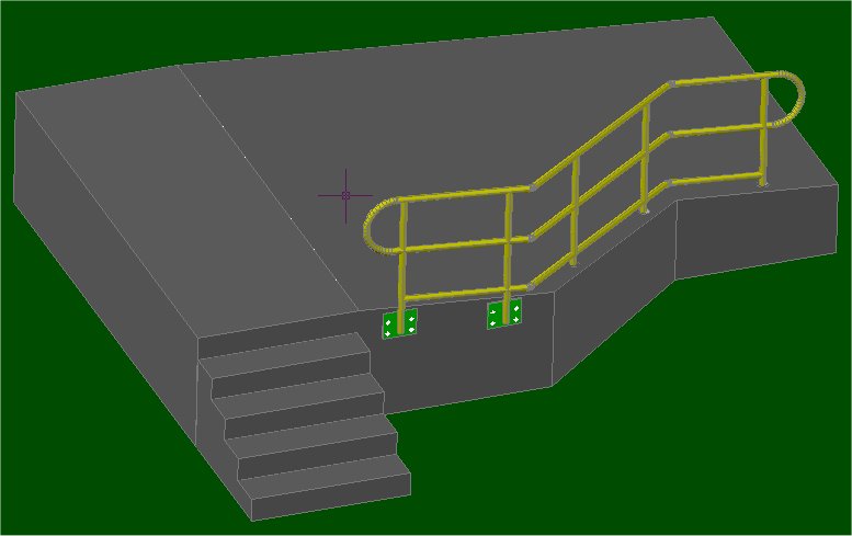

Bill Tillman Posted March 26, 2009 Author Posted March 26, 2009 Just for grins, this is why things can be so difficult with something that should be so simple. This handrail is on a sloping surface and part of it is mounted to the face of the concrete structure while the other part of it is mounted on top of the structure using core drilled holes. Anyway, tomorrow morning the shop starts fabrication and the foreman told me he will have it installed by Friday morning. Did someone say "Hurry up, faster, better, cheaper....!" Quote
