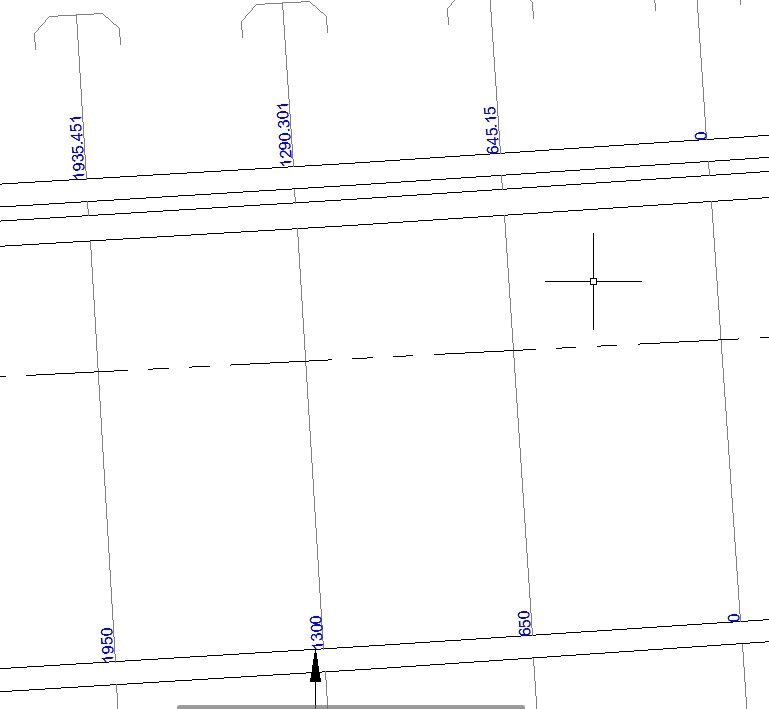

Hi mate, thanks for the response. I am trying to write something simple that will work in conjunction with a lisp that LEEMAC done (SP CHAINAGE).
I tried using the term UNITS which didn't work either.
The drawing units are set at 4 decimal places and rather than typing units and changing the precision to 0 I was going to try to write a small lisp file and attach to a toolbar button.
Image below shows text on the top in blue with 4 decimal places - dims o  the bottom with no decimal places.
@ASH71 Without knowing how Lee's program works - I can't help you. Does it create plain text, dimensions or text with fields? Again - I requested a sample drawing that would give more information than an image. Do you need to both create and edit existing values? Have you contacted Lee Mac from his website? I imagine Lee would be able to alter his program to accommodate your needs.
