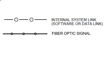

I have this code for software lines.
*software,software ---- 0 ---- 0 ---- 0 ---- 0 ---- 0 ---- 0 --
A,.025,-.1,[CIRC1,ltypeshp.shx,x=-.04,s=.04],-.1,.125
I need a code for Fiber Optic lines. The two linetypes are shown below. The appearance is similar but slightly different. Does anyone have such a code that they could share with me?
I struggled for an hour or so and came up with this. There is a small gap on the left side of the circle. Does anyone know how to close it?
*FIBER_OPTIC, FIBER_OPTIC ----O----O----O----O----O-
A, .2, .2,[CIRC1,ltypeshp.shx,x=.02,s=.04],-0.05, -0.05
fiber.dwg
The short answer is that you have specified too much of a gap. The CIRC1 shape at a scale of 0.04 is 0.08 in diameter. So the space (negative distance) should be 0.08, and you have specified 0.05+0.05=0.10 which gives the 0.02 gap.
I suspect you are just beginning to learn about linetype definitions, but to correct your code, I would amalgamate the two line sections and also the two space sections into one each. You do not need an x dimension because the insertion point of CIRC1 is at the left hand quadrant point. This would give the code line to be:- A, .4,[CIRC1,ltypeshp.shx,s=.04],-0.08
