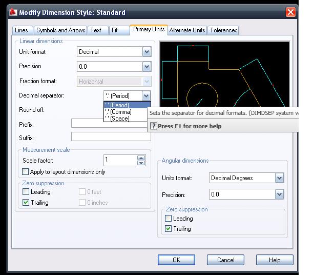

In autocad you can select comma under dimension styles.
It may be the same in MEP.
Dont shhot me down if it aint.

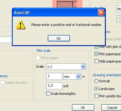

That works for dimensions, but still you can't use a comma in places like this apparently :(
