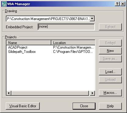

Attached are screen shots ofthe VB Mgr and the VB Editor.
In the VB Mgr I can not select the 'ACADProject' to Unload it.
As you can see in the VB Editor it has been created as a completely blank project with the name of teh file is the drawing name.
Once this appears, my guys get a 424-Object not found error becasue the menu calls can no longer see the Glidepath_Toolbox.
