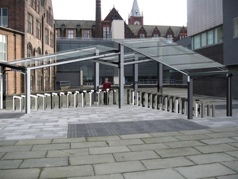

James Edwards Posted April 1, 2009 Posted April 1, 2009 Hi, im new to AutoCad and i've been learning over the past week. I really need someones help. I have made a 3d model of a bike shed and I now need to get this into top, side, and front view (like an engineering drawing) and dimension it. I also need to change the lines that you wouldn't see to "hidden" dotted lines. Can someone please tell me where to start? Quote
ReMark Posted April 1, 2009 Posted April 1, 2009 Does Civil 3D have such commands as Flatshot, SolView and SolDraw? BTW...your bike shed appears to be floating. What anchors it? Would you have plates at the ends of each column or will the columns be anchored into a concrete footing of some kind? Quote
James Edwards Posted April 1, 2009 Author Posted April 1, 2009 Yes it does have those commands. I've looked into them but I have not found much and im a bit stuck... Haha yes.. it does appear to be floating, its also too big (correcting that now) and it does not follow the laws of perspective.... Is what I'm trying to do relatively simple or should i just draw by hand? Quote
James Edwards Posted April 1, 2009 Author Posted April 1, 2009 oh also, its going to be bolted to the floor! Quote
