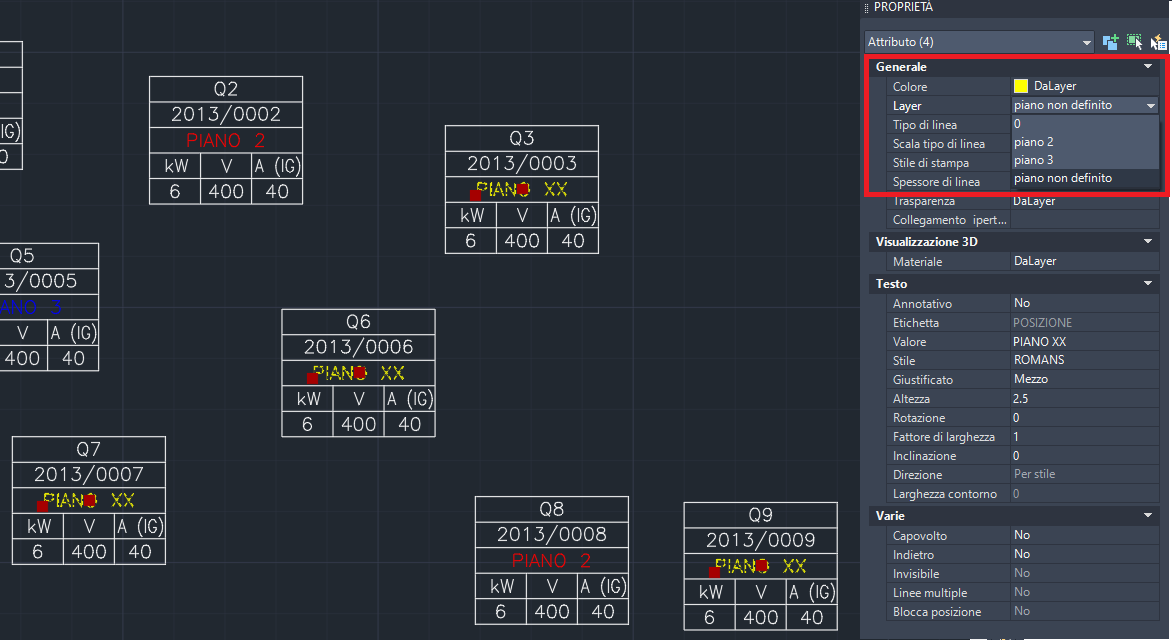

itacad Posted September 25, 2024 Posted September 25, 2024 Hi, I often manage the properties of some attributes in some blocks, associating them with dedicated layers to display them with different colors. This operation is very simple if performed individually for each attribute of each block. There are also many lisps for "passing" both the text and the properties of attributes between different blocks. However, I have never been able to perform a "group edit", that is, select a series of identical blocks and act on a certain attribute: - simultaneously filling it with an identical text string. - modifying its properties by associating them with a certain layer In the example I would like to modify with a single operation the text and layer of the POSIZIONE attribute of the blocks that have it filled in with PIANO XX Thanks in advance for any suggestions group edit attribute properties.dwg Quote
itacad Posted September 26, 2024 Author Posted September 26, 2024 Hi, in the meantime I made a useful discovery for modifying the properties of the attributes... if you hold down the ctrl key and select the attributes, in the properties bar you can modify them all together! It's little but it's something... Quote
