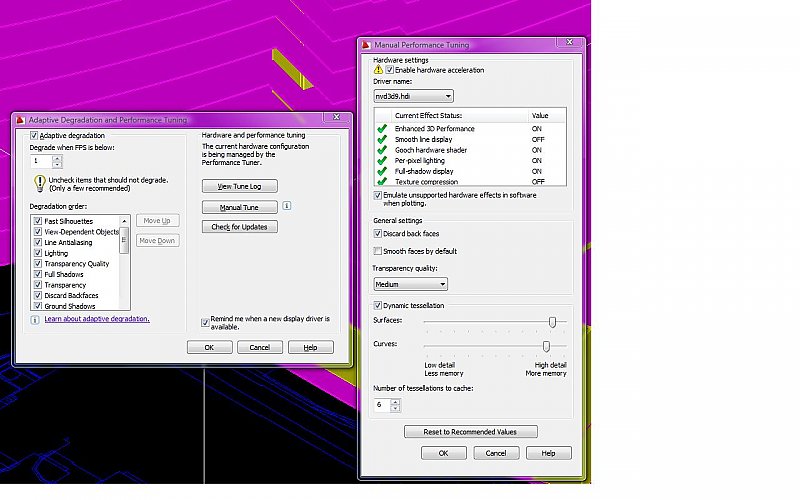

14 MB DWG that was an RVT 3d file. Things in his drawing are so slow its irritating to just open it. Are there settings in A-Cad to help its 3D functions run faster and smother?
Do you have Hardware acceleration turned on? type 3DCONFIG to see if you are or not.
and that is a VERY stout computer. you are running top of the line, honestly.
I think you have been "Vistamized" by your OS as I see no reason, system-wise, why you would be having such a hard time dealing with a 14MB 3D file.
Does this drawing have any Xrefs attached?
Has the drawing been purged?
Guest Brian_MMC
StykFacE,
I believe the Hardware acceleration is turned on. Do you see anything that could be improved? Please see attached. There looks like there is a Update. I will try that when I can get someone with admin. rights over here.

If there's an update, get it. Also, click the "View Tune Log" button and make sure it says that your hardware is Certified. :)

Also, I don't care what you have as far as performance in a computer, its not good to run in a "rendered" visual style. I work in wireframe unless I absolutely NEED to see what's going on, and I have a pretty stout machine myself.
