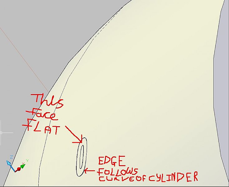

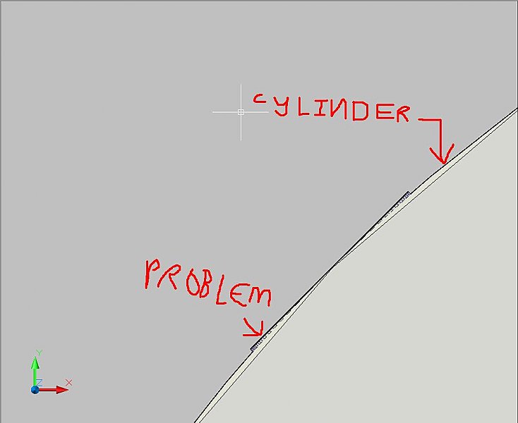

skipsophrenic Posted April 9, 2009 Author Posted April 9, 2009 Wish i could, Drawing siz = 15 mb max allowed e-mail 5mb, otherwise i'd have asked to do that, what i am gonna do is see if i can grap a couple of screenies w/out the details that people are worried about being put out on net. Quote
skipsophrenic Posted April 9, 2009 Author Posted April 9, 2009 second Screen grab from front view Quote

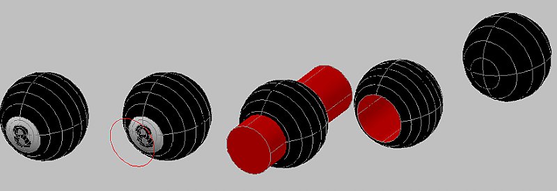

JD Mather Posted April 9, 2009 Posted April 9, 2009 Try this - not sure it will work create a circle and presspull or extrude and subtract to cut a cylinder or box down into the part. Then use the Solid Edit Delete Face and select the side and bottom of the cylindrical hole. If you are luck the original outside face will repair. BTW this would probably be pretty easy to repair with Inventor if you have access to it. If you can't figure it out hollar back and I'll post an example. Quote
JD Mather Posted April 9, 2009 Posted April 9, 2009 Here is an example going from left to right. On the left I have text both Imprinted (flush) on one side and raised on the other side of the ball. Cut away the text (in this case I went all the way through but you only need to go deep enough for a full cut. You have to be very careful about the faces to Delete - click in a face(s) not an edge. Well, my zipped dwg was too large so maybe the pic will be enough. Quote
skipsophrenic Posted April 9, 2009 Author Posted April 9, 2009 Thanking you both for your inputs, the delete faces option did the trick. Quote
