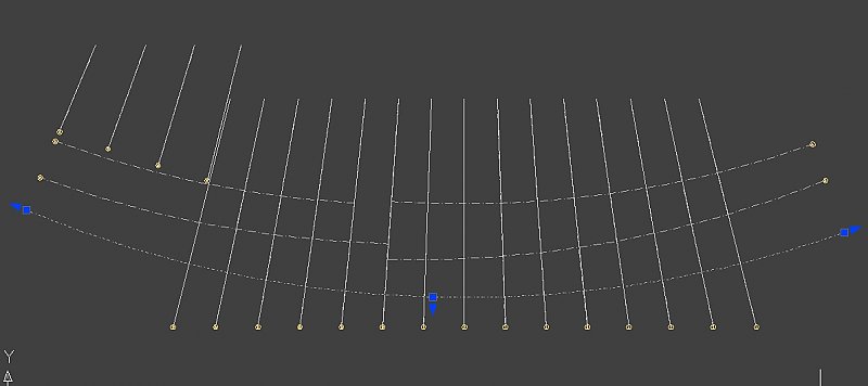

Hi
Here is what I think would be ideal - the same thing one can easily do in Archicad or Revit for example - but please, only if you're interested and you have time. The lisp DLA you made is great.
Picture 1 : The structural grid layout

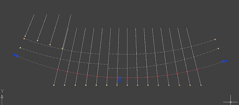

Picture 2 : choose an arc.

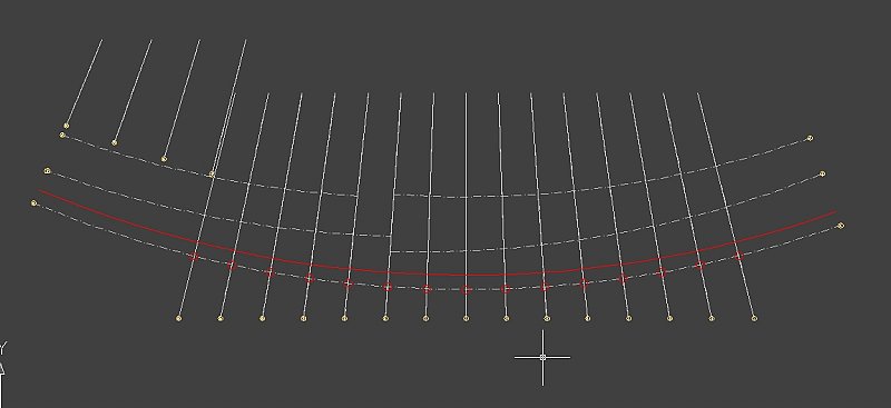

Picture 3 : choose all the points on the arc one needs to get arc lengths between

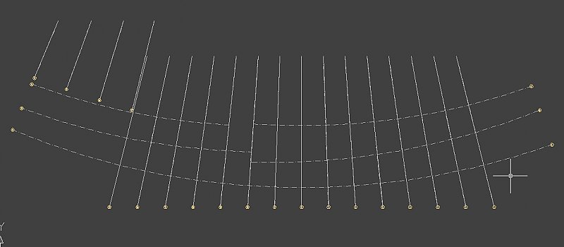

Picture 4 : The dimension line

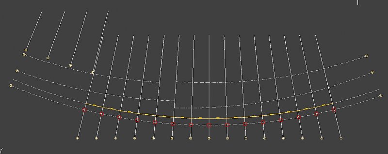

Picture 5 : place the arc lengths on the dimension line (or specify an offset dimension line).
Thank you !
