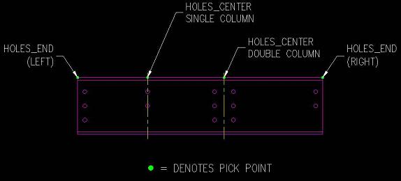

Impala62 Posted December 17, 2007 Posted December 17, 2007 Hi all, I detail in 2D structural steel. I am looking for a lisp that will create holes with option of offset guage line hole dia number of holes etc. Is there anything out there or close to this? Bill Quote

bsamc2000 Posted December 19, 2007 Posted December 19, 2007 Thanks brian....Hope you don't mind if I grab a copy..nice..simple..routine.. No problems. I hope it helps. Here is a modified version that draws end connections. I have a mutch more complete detailing program but I usually charge for that. (Sorry!) Brian (defun c:holes_center ( / rows cols rowd rowv rowh hole ) (setq rows (getint "\nEnter the number of rows (---) <1>: ") cols (getint "\nEnter the number of columns (|||) <1>: ") rowd (getdist (strcat "\nBeam guage <" (rtos 3) ">: ")) rowv (getdist (strcat "\nVertical center / center <" (rtos 3) ">: ")) rowh (getdist (strcat "\nHorizontal center / center <" (rtos 4) ">: ")) hole (getdist (strcat "\nHole diameter " (rtos 0.8125) ">: ")) ) (if (= rows nil)(setq rows 1)) (if (= cols nil)(setq cols 1)) (if (= rowd nil)(setq rowd 3)) (if (= rowh nil)(setq rowh 4)) (if (= rowv nil)(setq rowv 3)) (if (= hole nil)(setq hole 0.8125)) (setq ins (getpoint "\nSelect insertion point: ")) (if (> cols 1)(setq ins (polar ins pi (/ (* (1- cols) rowh) 2.0)))) (repeat cols (setq lstpnt (polar ins (* pi 1.5) rowd)) (entmake (list (cons 0 "circle")(cons 10 lstpnt)(cons 40 (/ hole 2.0)))) (repeat (1- rows) (setq lstpnt (polar lstpnt (* pi 1.5) rowv)) (entmake (list (cons 0 "circle")(cons 10 lstpnt)(cons 40 (/ hole 2.0)))) ) (setq ins (polar ins 0 rowh)) ) (princ) ) (defun c:holes_end ( / dir rows rowd rowh rowv rowo hole ) (initget 0 "Left Right") (setq dir (getkword "\nEnd of beam (Left/Right) <L>: ") rows (getint "\nEnter the number of rows (---) <1>: ") rowd (getdist (strcat "\nBeam guage <" (rtos 3) ">: ")) rowv (getdist (strcat "\nVertical center / center <" (rtos 3) ">: ")) rowo (getdist (strcat "\nEndge offset <" (rtos 1.5) ">: ")) hole (getdist (strcat "\nHole diameter " (rtos 0.8125) ">: ")) ) (if (= dir nil)(setq dir "Left")) (if (= rows nil)(setq rows 1)) (if (= rowd nil)(setq rowd 3)) (if (= rowh nil)(setq rowh 4)) (if (= rowv nil)(setq rowv 3)) (if (= rowo nil)(setq rowo 1.5)) (if (= hole nil)(setq hole 0.8125)) (setq ins (getpoint "\nSelect insertion point: ")) (if (= dir "Left") (progn (setq ins (polar ins 0 rowo) lstpnt (polar ins (* pi 1.5) rowd) ) (entmake (list (cons 0 "circle")(cons 10 lstpnt)(cons 40 (/ hole 2.0)))) (repeat (1- rows) (setq lstpnt (polar lstpnt (* pi 1.5) rowv)) (entmake (list (cons 0 "circle")(cons 10 lstpnt)(cons 40 (/ hole 2.0)))) ) ) (progn (setq ins (polar ins pi rowo) lstpnt (polar ins (* pi 1.5) rowd) ) (entmake (list (cons 0 "circle")(cons 10 lstpnt)(cons 40 (/ hole 2.0)))) (repeat (1- rows) (setq lstpnt (polar lstpnt (* pi 1.5) rowv)) (entmake (list (cons 0 "circle")(cons 10 lstpnt)(cons 40 (/ hole 2.0)))) ) ) ) (princ) ) Quote

bsamc2000 Posted December 19, 2007 Posted December 19, 2007 Try this. Brian (defun c:holes_end ( / cols dir rows rowd rowh rowv rowo hole ) (initget 0 "Left Right") (setq dir (getkword "\nEnd of beam (Left/Right) <L>: ") rows (getint "\nEnter the number of rows (---) <1>: ") cols (getint "\nEnter the number of columns (|||) <1>: ") rowd (getdist (strcat "\nBeam guage <" (rtos 3) ">: ")) rowv (getdist (strcat "\nVertical center / center <" (rtos 3) ">: ")) rowh (getdist (strcat "\nHorizontal center / center <" (rtos 3) ">: ")) rowo (getdist (strcat "\nEndge offset <" (rtos 1.5) ">: ")) hole (getdist (strcat "\nHole diameter " (rtos 0.8125) ">: ")) ) (if (= dir nil)(setq dir "Left")) (if (= rows nil)(setq rows 1)) (if (= cols nil)(setq cols 1)) (if (= rowd nil)(setq rowd 3)) (if (= rowh nil)(setq rowh 3)) (if (= rowv nil)(setq rowv 3)) (if (= rowo nil)(setq rowo 1.5)) (if (= hole nil)(setq hole 0.8125)) (setq ins (getpoint "\nSelect insertion point: ")) (if (= dir "Left") (progn (setq ins (polar ins 0 rowo)) (repeat cols (setq lstpnt (polar ins (* pi 1.5) rowd)) (entmake (list (cons 0 "circle")(cons 10 lstpnt)(cons 40 (/ hole 2.0)))) (repeat (1- rows) (setq lstpnt (polar lstpnt (* pi 1.5) rowv)) (entmake (list (cons 0 "circle")(cons 10 lstpnt)(cons 40 (/ hole 2.0)))) ) (setq ins (polar ins 0 rowh)) ) ) (progn (setq ins (polar ins pi rowo)) (repeat cols (setq lstpnt (polar ins (* pi 1.5) rowd)) (entmake (list (cons 0 "circle")(cons 10 lstpnt)(cons 40 (/ hole 2.0)))) (repeat (1- rows) (setq lstpnt (polar lstpnt (* pi 1.5) rowv)) (entmake (list (cons 0 "circle")(cons 10 lstpnt)(cons 40 (/ hole 2.0)))) ) (setq ins (polar ins pi rowh)) ) ) ) (princ) ) Quote
Impala62 Posted December 19, 2007 Author Posted December 19, 2007 Thanks Brian, It works great. One last request. And I understand if you say no, you've helped out alot here. What if I wanted to instead have user input for columns they had the optionof ofset a series of columns. I work alot with Steel angle and there are many times there is a run of holes along the length. So a user would choose 1 or 2 rows, beam guage, hole dia., but is triggered to ask for 1st offset, 2nd offset, 3rd offset Thanks again. Bill Quote
