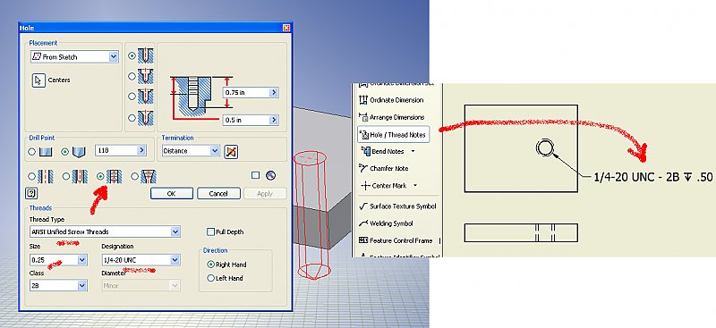

Do not add threads to holes like you do to shafts. Have Inventor automatically look up the tap drill size by using the Thread type hole in the Hole feature dialog box.
Because it places the hole smaller there will be interference between assembled fastener and hole (fastener isn't going to just drop into the hole with no thread engagement).
When it comes time to do the drawing you don't manually enter the thread note - use the Hole/Thread Notes dimension tool and Inventor automatically picks up the thread information from the model.
see attached
So I cant thread holes!?!? INv makes the hole smaller than the shaft of the same nominal size? Thats sucks. So I guess I could have two file of a part like that I guess. One with tapped holes showing the part not in use and one without threads for using the part in an assembly.
Of course you can.
Have you ever taken a basic machine shop class? The hole has to be smaller than the shaft or there will not be any material to cut the thread with a tap. This is called the tap drill size. You've got a long long long way to go.

Oh yea I know that. The bolt diamter is roughly the major of the thread and the hole diameter is roughly the minor ofthe thread.
But in INV,... if I thread a hole at a certain size using the hole feature and then go ahead a thread a bolt for that certain thread size using the thread feature,.... the diameters for each will be different? Thats what your saying right?
If thats true,... I can say I like it becuse it's accurate but at the same time I dont because as you said before, there will be interference between the two if I put the bolt in the hole. That would leave me with having to keep the hole unthreaded with the bolts diameter.

Doing a threaded hole is actually a lot more straightforward than that in INV. In your workshop, in the metal, you're going to have to drill the right size hole in accordance with the recommended tapping drill size. In Inventor, using the hole tool, you just place your hole center as required, select the threaded hole option, specify the thread in the dialog box, set the depth, and that's it, the program does it, including simulating the thread in the model. It's rather nice. JDM's screenshot is of the hole tool dialog box showing the threaded hole option selected.
On assembly, the insert option just fits the bolt into the hole no worries, as long as you're not fitting a 3/4" bolt into a 1/2" hole of course!
In the 2D drawing file, as JDM also advises, the thread details for the hole are picked up by the hole/thread notes tool from the model. It's left to the technician on the shop floor to refer to his tables to pick the correct drill, us designers just say what thread size we intend.
Hope this helps
