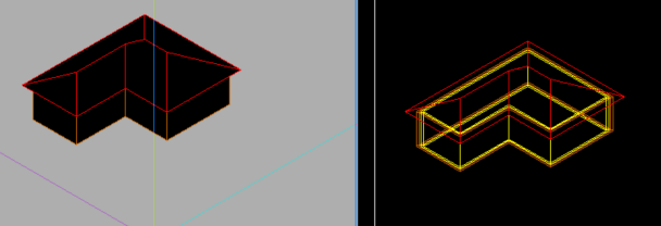

katie.dim Posted November 30, 2024 Posted November 30, 2024 Hi guys! I'm a first year student in Architecture and I need help! Here's my two questions: 1) I need to fill in the wall that reaches the roof. At the moment, I can only make walls at a 90 degrees angle (boxes), not a unit in an ascending/descending angle. 2) Around the windows below on the right, I joined all boxes but the (white) lines between them remain. How can I get rid of those? Image (https://ibb.co/4Sw468N) Thank you so much! Katie Quote
ReMark Posted December 1, 2024 Posted December 1, 2024 (edited) Is the building steel framed, wood framed or masonry? Technically speaking a building would not be constructed in this manner. For example, there is nothing on the top of the walls, such as trusses, supporting the roof above. That aside, one option would be to extend all the walls through the roof then SLICE them using a polyline drawn at one end of the gable roof and extruded through the other end. Another option would be to draw and extrude a matching profile unique to each section of wall under the roof. Re: visible edges. Choose a visual style like REALISTIC or SHADED to hide the edges. Edited December 1, 2024 by ReMark Quote
BIGAL Posted December 1, 2024 Posted December 1, 2024 (edited) Another method for roofs is using PFACE command it supports 3d points but they must be in a single plane so for your image would do pface twice. This image was produced just using plain autocad command. Note the use of thickness in the wall line work. Similar to your image windows are drawn vertically for frames. When you use thickness it also asks for elevation so can draw each floor seperate then just move over the top of each other. Use "hide" in a viewport For elevations look at using a viewport and set the direction via Vport eg 3d is -1,-1,1. Right is "1,0,0" Edited December 1, 2024 by BIGAL Quote

danellis Posted December 2 Posted December 2 What programme are you using, and what level of detail do you need to model to? If you're looking to produce construction-type drawings, then, as Remark said, you need to keep the tops of your walls flat but show other elements to achieve the junction. If you're using AutoCAD Architecture to produce less detailed/non-construction drawings, then it has a command to "extend wall to roof" (I think that's what it's called-try a right click on the wall) that will sort it for you. If you're using some other software, you'll have to investigate how that software works- hopefully your training material covers it, or google or someone here will. dJE Quote
