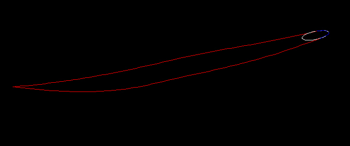

wdj Posted April 12, 2009 Posted April 12, 2009 im designing a boat with a rounded stern i have the loft lines from the bow to the stern ok but i drew a circle for the stern and connected the lines tangentialy to it but the circle dosnt flow with the upward curve of the loft line, how can i do that? Quote
CADMASTER1128 Posted April 12, 2009 Posted April 12, 2009 im designing a boat with a rounded stern i have the loft lines from the bow to the stern ok but i drew a circle for the stern and connected the lines tangentialy to it but the circle dosnt flow with the upward curve of the loft line, how can i do that? Can you post the drawing...I need to see what you have done Quote

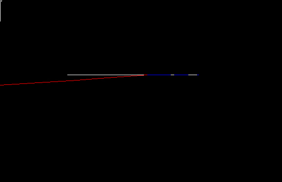

wdj Posted April 12, 2009 Author Posted April 12, 2009 her are a couple i think show what i mean Quote
CADMASTER1128 Posted April 12, 2009 Posted April 12, 2009 Are you wanting to have the loft line Parallel with the Circle? (Stern) Would it be possible to email the .DWG File to me? Quote
wdj Posted April 12, 2009 Author Posted April 12, 2009 i want the circle to follow the line of the loft instead of being flat this is the dwg file hull.dwg Quote

wdj Posted April 12, 2009 Author Posted April 12, 2009 i rotated the drawing 5 deg which was estimated then drew a new circle and trimmed then rotated it back, its sloppy but its close Quote

SEANT Posted April 13, 2009 Posted April 13, 2009 Is the interim step of aligning the arcs to the connecting splines required? If so then: Flatten a copy of the splines, offset, snap to two endpoints to create a perpendicular vector, rotate with “Reference” to align circle with perp vector. See attached. hull2.dwg Quote
