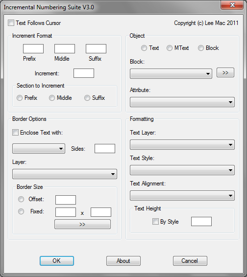

A little preview of something I've been occasionally working on...
Finally got the dialog looking how I want it :)

Incremental Numbering Suite Version 3.0 released.
The program is now faster & smoother and has become my largest and most developed application, with many new features and updates included in the new version, a handful of which I have listed below.
I have also completely rewritten the program description to give a more complete overview of the program capabilities.
  • Program completely rewritten to improve program performance, update code formatting to improve readability and include the following new features:
  • Ability to use Text, MText or an arbitrary Attributed Block to house incrementing string.
  • Ability to change Text / MText Alignment.
  • Ability to toggle the use of a Background Mask with MText.
  • Ability to specify and pick both dimensions for the fixed size Slot / Rectangular border.
  • Vastly improved alphabetical text incrementing.
  • Improved handling of negative numbers with decimals or leading zeros.
  • Dialog interface completely redesigned to make it more user-friendly and intuitive to navigate.
  • Immensely improved non-dynamic mode interface & functionality.
  • Program works in all UCS/Views correctly.
Since the entire program has been rewritten there are likely to be some bugs lurking in the code, so I challenge you to find them!
