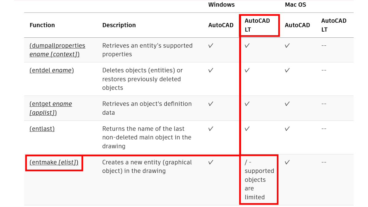

I have an AutoLisp program that uses the Entmakex function to create a non-graphical object.
Everything was fine until a few days ago, when I installed AutoCAD 2025.1.1.
The program stopped working and it took me a while to understand that the Entmakex function was the cause.
I looked around the net and found something similar for Autocad LT, which has restrictions on the use of Entmakex.
From what little I understood, Entmakex from Autocad 2025 behaves as if it were AutoCAD LT.
Any ideas?
I discovered the AutoCAD LT problem in this way: someone reported the bug and AutoDesk replied: it's not a bug, we did it on purpose for the LT version. (Why,  I wonder)
OK, but what about the full version?
https://help.autodesk.com/view/ACDLT/2024/ENU/?guid=GUID-3F9A2EB2-082D-49DD-8EFD-DAD8F6E9AA6A
https://help.autodesk.com/view/ACDLT/2024/ENU/?guid=GUID-1197B695-C73C-4B4D-AD5D-8F8EB64FB253
