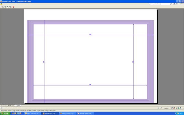

FazBear Posted December 19, 2007 Posted December 19, 2007 Stumped on this one! I have set up an A3 size print style (420x297mm) with 5mm margins all around. i am plotting a drawing to its extents (400x277mm) which should leave 5mm between the drawing extents and the page margins. when i preview the page it looks perfect. however when i open the created .pdf the result is somewhat different. the spacing left to right is spot on but vertically the drawing is off the top of the page approximatly 15mm. i have tried many things to try centre the page but the closest i can get it is a 13mm margin at the bottom and 2mm margin at the top, achieved by unchecking the centre the plot box and inputting 0 for the y offset. any help here would be greatly appreciated. Regards Quote

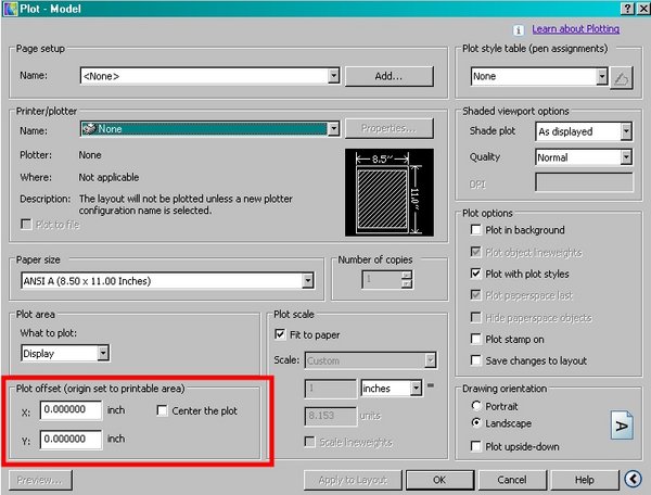

Guest Alan Cullen Posted December 19, 2007 Posted December 19, 2007 All plotters have a plot origin offset. That's why there is the option to set it in the plot dialogue. What you have to do is figure out what that offset origin is. What we do is draw up an A3 outline, then draw in lines through it north and south. And tick off mm marks starting at all the borders, then plot as normal. The plot will show you the offsets because that is where the mm marks will stop. Hard to explain, but when you try it, you will immediately see what I am talking about. Quote
FazBear Posted December 19, 2007 Author Posted December 19, 2007 Ok So once i determine how far the plotter callibration is out, how do i correct it? Quote
Guest Alan Cullen Posted December 19, 2007 Posted December 19, 2007 Just enter it here in the plot dialogue box: Quote

FazBear Posted December 19, 2007 Author Posted December 19, 2007 i have attached an example of whats happening. the print preview.jpg is a screenshot of my print preview the test.pdf is the pdf output Notice the margin top and bottom! test.pdf Quote

FazBear Posted December 19, 2007 Author Posted December 19, 2007 thats what i have done to get the drawing central as the test.pdf i have the margins set to 35 top, 5 right 5 left and 0 bottom as the print preview shows. problem is the test.pdf doesn't reflect the margin properties as the print preview shows. Quote
