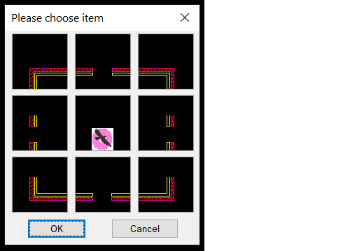

Have you thought about using a IMAGE dcl you should be able to click on the ones you want making a list behind the scenes, I have 2x2 3x3 4x4 images etc.
you probably want something like this but without showing complete code or dialog we have to use our crystal ball (mine is broke so I used my wife's)
