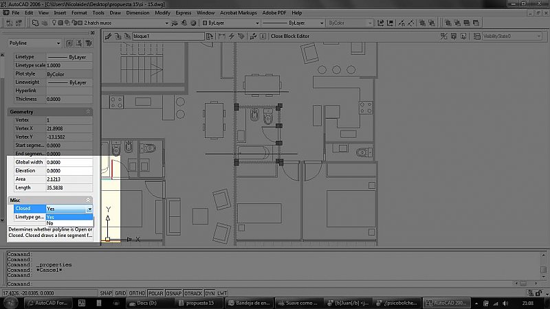

nicogarcia Posted July 11, 2010 Posted July 11, 2010 Look, I had the same problem and it´s fix when y close the poliline from propiertis panel. Quote
