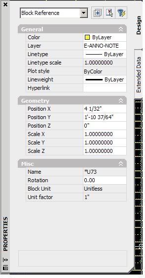

Perhaps you could post a screen shot. Usually the full path will be there. Try using Properties and highlighting the path and scrolling with your arrow on the keyboard.
Here is a screen shot of the properties box:
I don't see where the path would be, unless I am misunderstanding you.

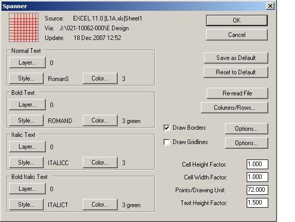

Here is a screen shot of the sheet update box:
As you can see, this only gives the first part of the path. Hopefully these help.

Back to the problem. It looks like a bit of sloppy programming - the sort of thing I would do - but can possibly be excused as it may have been written before very long path names became common. Basically the "label" isn't long enough for your file path and you can't read the end part. You MAY be able to double click the file and copy/paste it into a text document to read it. I just tried it in VB and it doesn't work but your one might be different.

I used the SU at the command line. SU=sheet update, I will ask you the “Select Spreadsheet”. Select a schedule in CAD and the Spanner Dialog box will show at the top of the box the file and path.

A simple fix:
Go to your root directory for Autocadd
  • C:\Program Files\AutoCAD MEP 2009
Open file Span12.dcl
on first page find this section:
:concatenation {
:text_part {
label = "Via: ";
:text_part {
width = 50;
key = t_vi;
Change width = 50 to width = 90
and save :roll:
