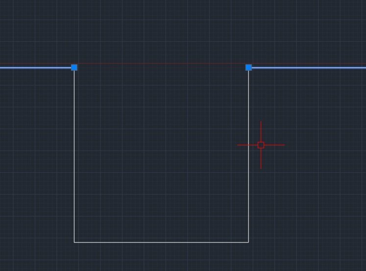

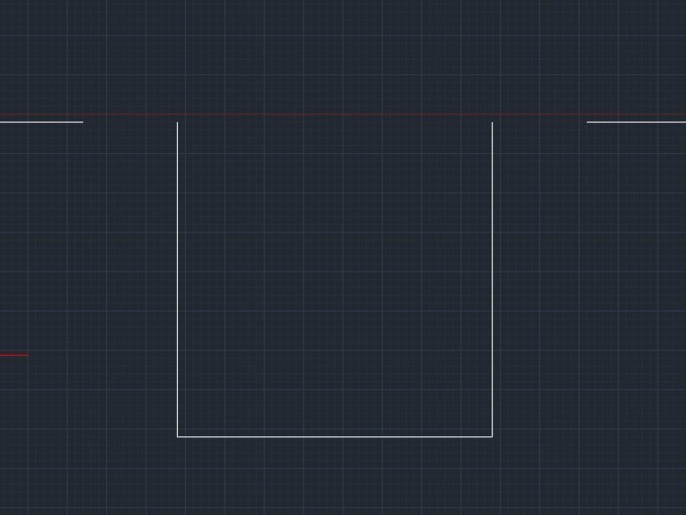

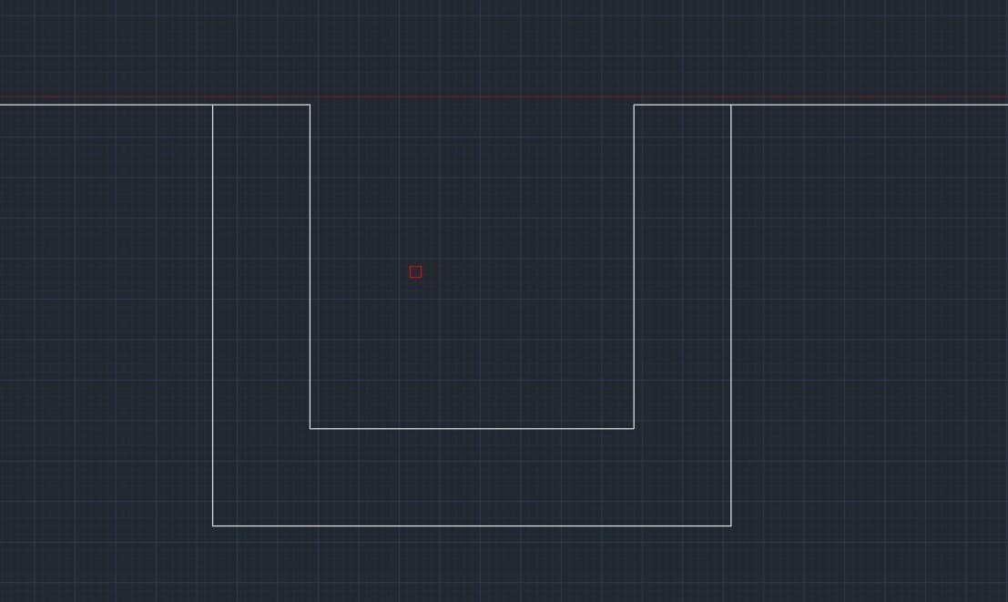

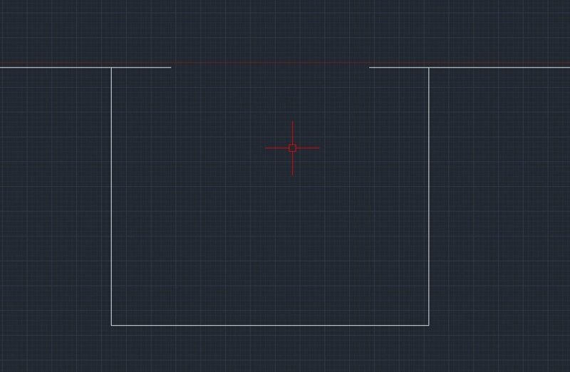

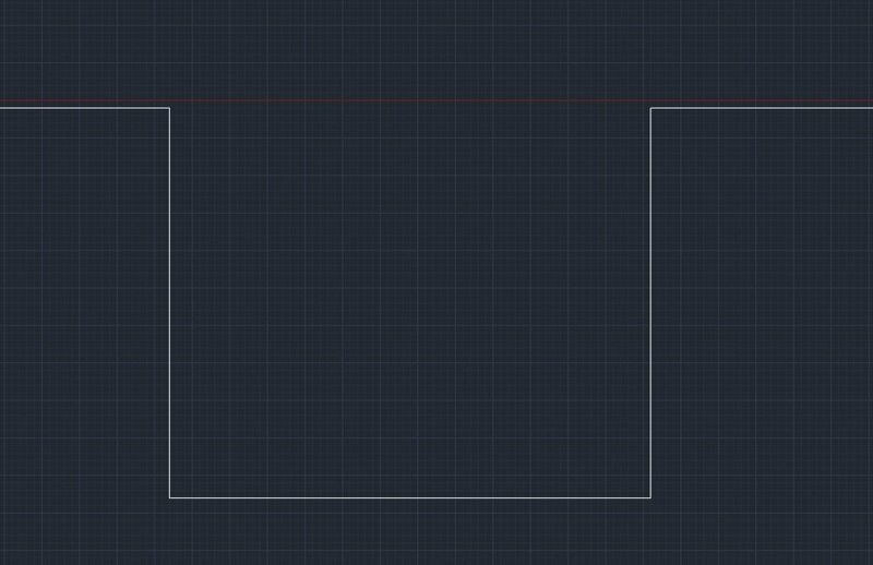

I just registered to check if there is a command or any script that you know of that can offset a squere polyline, delete the original polyline, and reconnect the neighboring lines to the new offset. (I made an example of how it should work.)

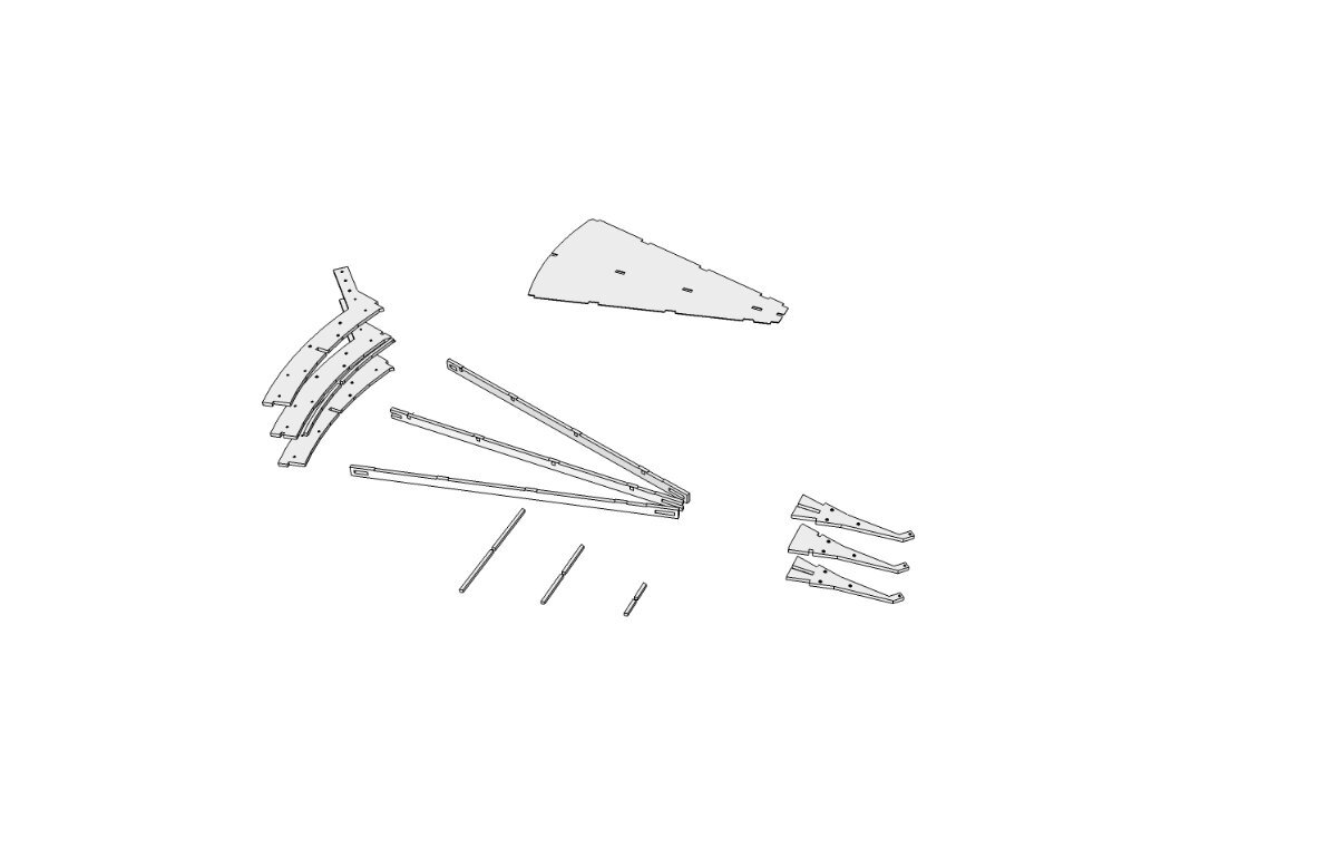

Recently, I gave myself a new DIY project to make a new console stair in the house by using a CNC laser. I made them in SketchUp using a tab-and-slot system, but now, since I did it without reserving any tolerance gaps, I need to resize all the slots. There are more than 400 pieces with multiple tab & slots. Recently, I spent 3 hours with ChatGPT trying to make the script, but I don't think it understood me.😅
The slots don't necessarily need to be parallel or perpendicular to the X axis. They can be oriented in any direction along the XY plane, including diagonally or at any other angle.
Any help would be excelent.
On iPad at moment, if the shapes are plines may need to explode. So can get at each segment, I am not sure how we would identify a slot. The offset and trimming can be done.
Post a sample dwg only need a few shapes not 400.

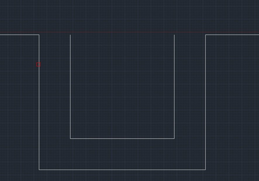

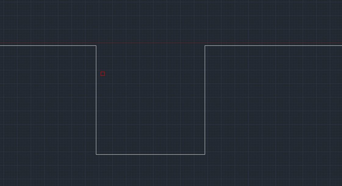

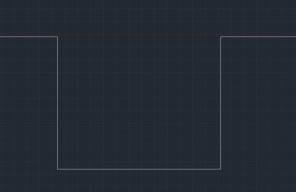

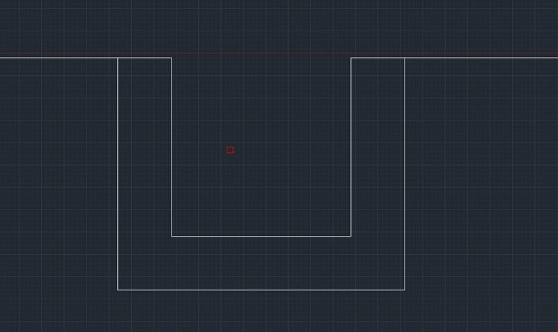

Thanks for response BIGAL, I uploaded 2 drawings and some photos to easier understand what I want.
Idea wasnt that I run the script and that it automatically corrects all the slots, but rather that I select one slot by slot, even join them to pline if necessary, and running the comand which ask me to input the offset.
Now I have to join the slot  lines in pline, make an offset, trim the connecting lines and trim the offset lines depending if I am making inner or outer offset. Everything said nothing isnt a big deal, if there wasnt so much slots which needs to be offseted by 0,1 or 0,2mm.

I made something just pick the outer edge it must be a pline, you can then get all 4 points that make up the outstand and offset them all by an amount, thought I had it solved but then it stopped working on an edge where the start point is an edge point. In this situation have to look backwards on a points list.
Hopefully will solve for you. have to go now.
Image is very nice detail.
Please try this let me know how it goes.
