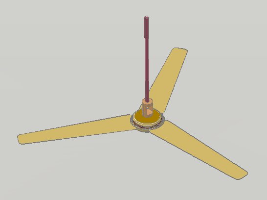

humaironline Posted April 16, 2009 Posted April 16, 2009 Sir, I made a 3d fan in cad 2007. now i want to rotate it in 360 deg continueosly but in 2 axis. when i move it by mouse. it rotate in abnormal manner. pls help me to rotate it in proper manner using orbit option as actual fan move. Quote
ReMark Posted April 16, 2009 Posted April 16, 2009 Use constrained orbit. From AutoCAD Help file: "If you drag the cursor horizontally, the camera moves parallel to the XY plane of the world coordinate system (WCS)." Quote
fuccaro Posted April 16, 2009 Posted April 16, 2009 You can write a short Lisp or script file for animating it. Quote

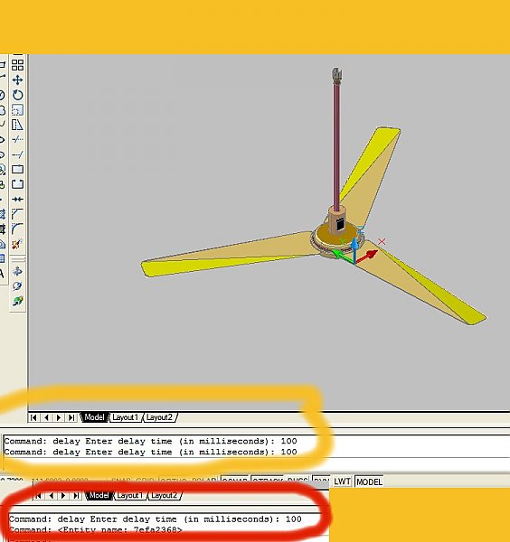

humaironline Posted April 21, 2009 Author Posted April 21, 2009 I applied same setting but... pls check the error....showing at bottom of screen..... Quote
fuccaro Posted April 21, 2009 Posted April 21, 2009 I use AutoCAD 2006 and after running that Lisp the command line shows the same as in your case. It is not a bug report, it is just the way the program works. Does it not rotate the block on the screen? Quote
