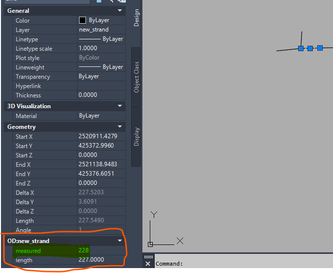

can anyone create lisp help, so the "measure" attribute of line can be extracted and put above the line as mtext with ft(') symbol.

@smitaranjan The "OD:New_strand > Measured" property must be from a custom application or vertical. It does not show up in my properties when opening the drawing in vanilla AutoCAD, So personally I would not know how to extract it without knowing what created it.
@dexus Note - the property shown on the OP's drawing is a custom one, which seems to be a rounded representation of the length? In any case, it doesn't precisely match the actual length of the line (227.5203), as your routine pulls. The OP asked that the value of the property is to be extracted, but that is not a standard property of the line for AutoCAD.

YES. The solution I GOT IT. Can be done and extracted with "MAPANNTEMPLATE" and then MAPANNTEXT(selecting the object property) and then using MAPANNINSERT can be placed.
