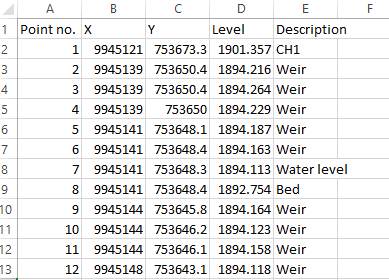

How to load excel file containing following data
What are you trying to do?
Datalink, Copy and Paste Special, lots of LISP, etc. out there.
You need to be more specific.
Raw 1 =  Point number
Raw 2 =  X coordinates
Raw 3 = Y coordinates
Row 4 = Level of point
Row 5 = Description

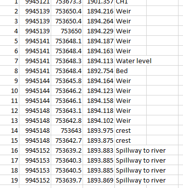

I want to plot ponit on cad and write point number and description near it
You can also read direct from Excel I have commented many times about doing this. The simplest way is to insert a block with 2 attributes. I think I solved that exact question a little while ago will try to find.
Have a look at Lee-mac points manager lisp. https://lee-mac.com/ptmanager.html
Ok a couple of more questions are you looking at stringing the points based on the description, ie Fence. Do you want a surface of the points ? I ask as the points are a typical CIVIL field code input. There is software out there that will do what you want including points by layer depending on description which matches a Block eg Tree6. 6m dia tree.
