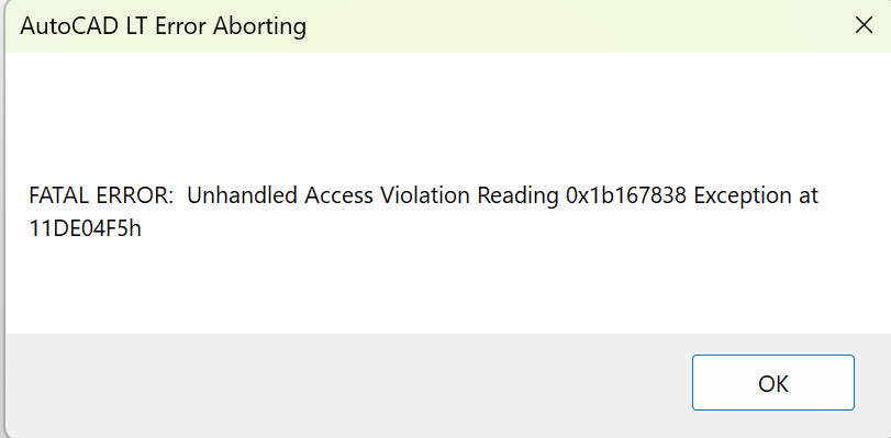

I have a legitimate perpetual licence for LT 2022, originally purchased a few years ago, with the maintenance subscription, which could not be renewed when they switched to only subscription options.
Its worked well up until yesterday, 2025-01-12, now i get an error on opening, which will not let me proceed, same thing on both laptops!
The error response says i need to upgrade to V1.4, however there seems nowhere on their website where i can do that, perpetual license's seem to have zero options.
I did note that Windows updated twice shortly before?
Anyone else have this problem?
Thanks,
Did you go through this article? "FATAL ERROR: Unhandled Access Violation Reading ... Exception at..." when launching AutoCAD products
I believe you should be able to update 2022, you need an Autodesk account. A quick search showed as far back as 2021 versions still supported and perpetual licenses can be set up for offline, best I can recall.
Autodesk Account Basics | Previous Product Versions | Available Versions
Thanks, appreciated, after signing in to my account, there are no products or services shown, seems like I've been erased, how do i get that info back on my account?

Did you try the steps in the link I posted?
You may need to contact Autodesk. Contact Customer Support | Autodesk Support
Here is a forum post at Autodesk, at least one person found a solution without contacting Autodesk. Solved: No more access to perpetual license products? - Autodesk Community
Using incognito in a different browser to access their account worked for the original poster.
