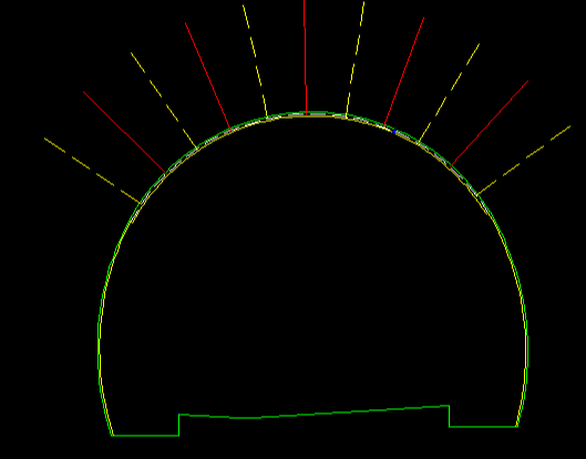

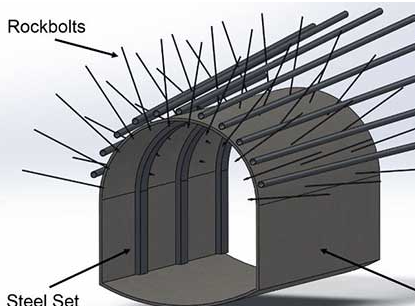

The only part I need help with is adding rock bolts to the tunnel body (mostly perpendicular, as shown in the photo below).

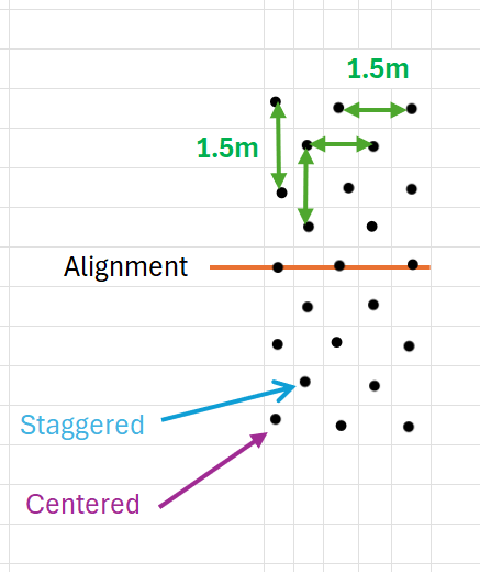

These bolts are positioned along chainages defined by the alignment and follow a staggered pattern.

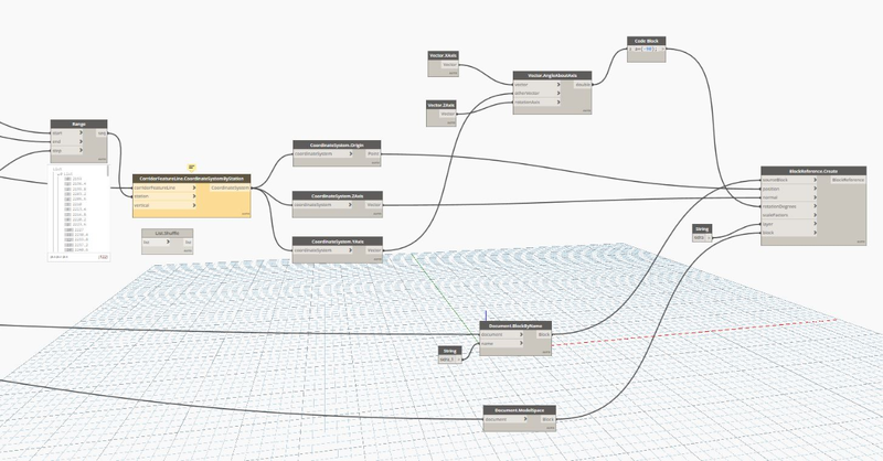

I searched online and found a Dynamo script (only screenshots of the script). I tried replicating it in Dynamo, but it didn’t work for me.

-Define the bolt pattern (centered / staggered).
-Set the spacing between bolts.

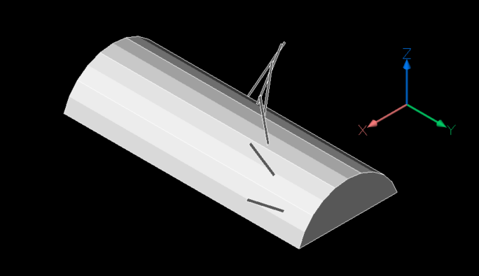

I am currently working on a tunnel corridor and need the rock bolts to be positioned on the body of the corridor. While I can convert the corridor into a 3D solid and manually place the bolts, I am looking for an automated solution due to the large number of bolts required.

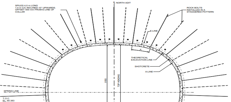

I have attached a file that includes rock bolts created by someone else for a different project (unfortunately, I have no contact with them) and a 3DFace representation of the tunnel. I need a solution that replicates the rock bolts exactly as shown in the file, but applied to the tunnel corridor I’m using.

If you zoom in close then can see that a point is on a 3d face. So there will be formula for a 90 to a face or use ucs in some way.
I really have no idea where to start as I used a simple shape so just used a move Z, working out 3d points on the faces is where I stopped, so I don't think I can help you, will email some one I know maybe he can help. The issue is when the 3dfaces make a non parrallel shape ie one end is different to the other.

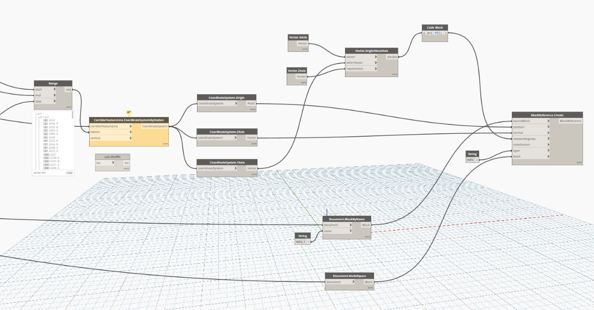

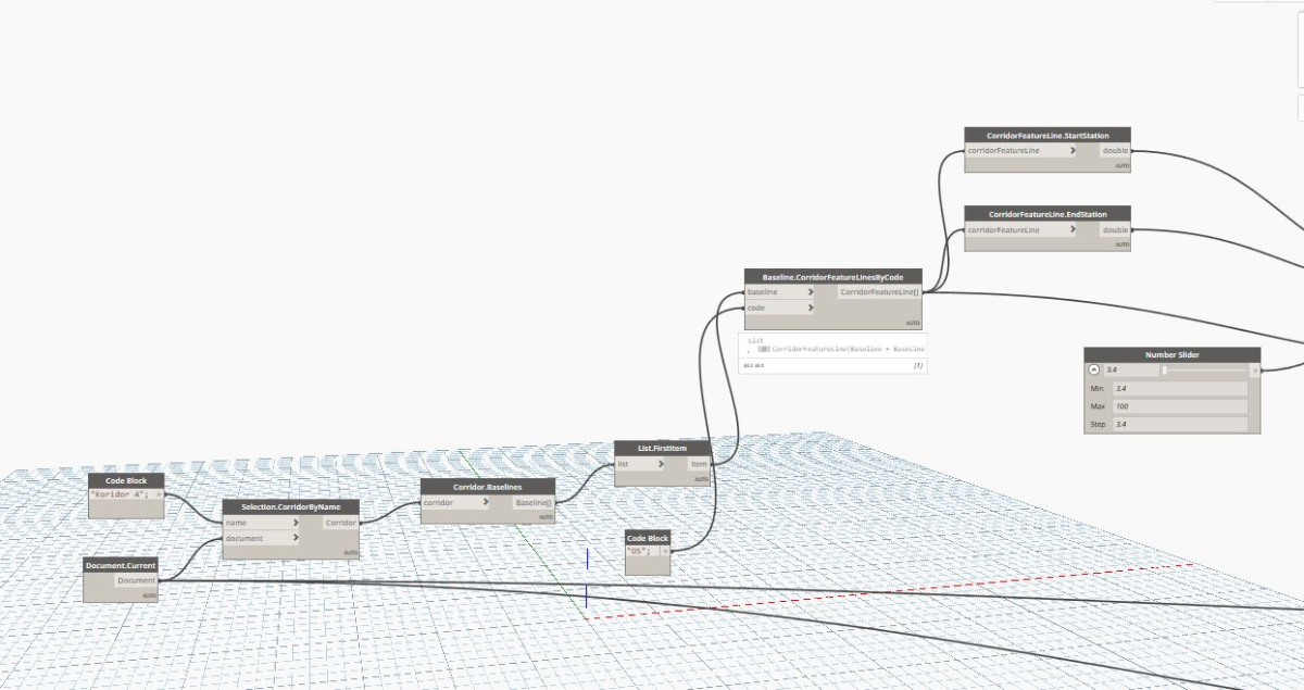

USE Dynamo  IN CIVIL  drawing
Hello hosneyalaa,
Can you please attach the Dynamo images with high resolution. Thank you!
If you could please attach the dwg example and Dynamo file. I appreciate this. Thanks!

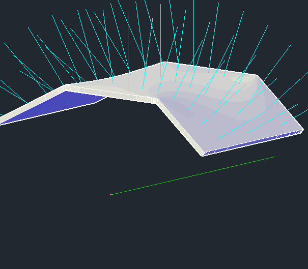

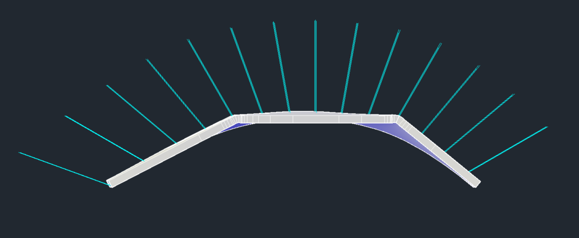

On 1/23/2025 at 12:12 AM, hosneyalaa said:
@hosneyalaa thank you Hosneyalaa!, and sorry for the delaying of my reply. I tried it but found that the lines are not perpendicular to the 3d object. Also, can I start those lines from a specific range of chainage (e.g. CH +15.00 to CH +30.00), control how many in raw, the second line should be in Staggered(photo attached), last thing  to add all these lines to a layer (each raw in a layer with the name of the chainage that the line on it). a gain thank you so muchi
