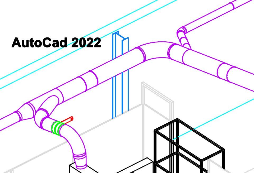

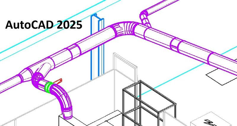

Ashley Posted January 17 Posted January 17 I have just updated my Autocad 2022 to Autocad 2025, when i go to print my drawings, i have got loads of extra lines visible than before. I have attached a screen shot from each program, from the pdf print. Please can somebody tell me what setting i am missing, i want it to print like 2022. Cheers Ash Quote
ReMark Posted January 17 Posted January 17 (edited) Could it have anything to do with the Visual Style setting? Edited January 18 by ReMark Quote
lrm Posted January 18 Posted January 18 Try changing the Edge Settings in visualstyles to Facet Edges. 1 Quote
