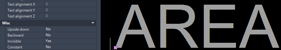

Hi Ament,
Blockedit the block and update the Invisible property of the Attribute definition (Area) object to "No". close the block editor and save. Type ATTSYNC at the command line and select the block to be updated. The filed value to be selected should now be visible.
8 hours ago, Ament said:
Hi Lee Mac, thank you for your help, I've tried to use it without any modification, but when selecting the block that is containing the attribute I only get back "Selected object is not a field, or field doesn't reference any objects." I guess when selecting the block I'm missing the link to drill down to the attribute called "AREA" to pass that into the function from above.
Unfortunately I've big difficulties to find that using my macro skill. :(
You'll need to invoke the function with the attribute entity, or select the attribute reference using the test program (which uses an nentsel selection).
I think a test implementation of Lee's code for your blocks could be:

I wouldn't rely on the attribute order, but rather acquire the attribute reference entity using its tag identifier, e.g.:
(cond
    (   (not (setq ent (car (entsel)))))
    (   (/= "INSERT" (cdr (assoc 0 (setq enx (entget ent)))))
        (princ "Selected object is not a block.")
    (   (/= 1 (cdr (assoc 66 enx)))
        (princ "\nSelected block is not attributed.")
    (   (progn
            (setq att (entnext ent)
                  atx (entget  att)
            (while (and (= "ATTRIB" (cdr (assoc 0 atx))) (/= "AREA" (cdr (assoc 2 atx))))
                (setq att (entnext att)
                      atx (entget  att)
            (= "SEQEND" (cdr (assoc 0 atx)))
        (princ "\nAREA attribute not found in selected block.")
    (   (LM:fieldobjects att)   )
