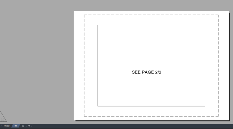

I wrote a message on page 1 in the layout. Currently, there are only 2 pages in the layout.

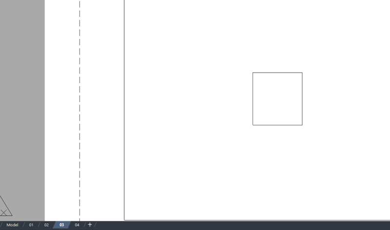

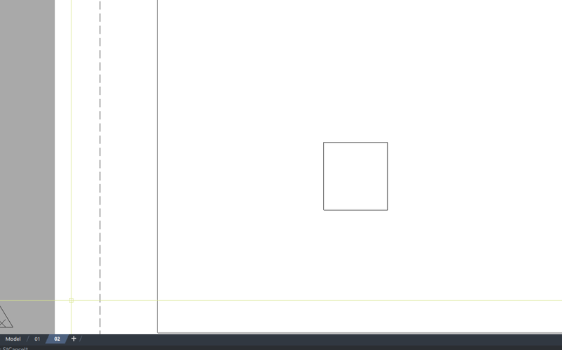

This is an object on page 2.

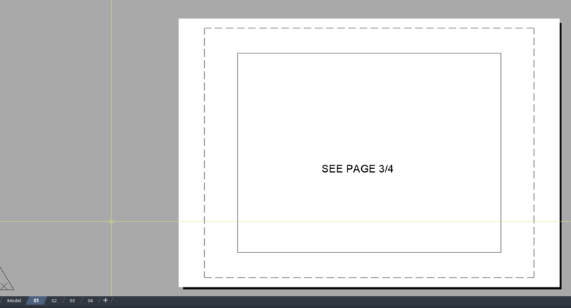

Then, when I added the layout to have 4 pages, the object from page 2 moved to page 3.Screenshot2025-01-24112250.thumb.png.ebc6aaa9743c433c283fe2f398a54f7b.png
I want the text I wrote as "Page 2/2" to automatically change to "Page 3/4." Is it possible to do this? Where should I start learning? I once saw a Lisp by Leemac that automatically changes the Layout page. I wonder if it could be adapted for this purpose.
