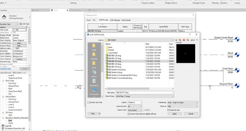

Hi.  I am trying to import different Autocad DWG files each representing a floor in Revit.  I have only been able to import the Ground Floor but in "place at" the different floors that do appear in the project browser, elevations etc. are not listed.  There is a NGL which appear in the list but is not listed in the project browser. Thanks for your help.  In case I find an answer I will post it here.
HI ok I finally found a solution to the problem. I need to be in the targeted floor when importing a cad file to position or to place onto it and it listed in the "place at" drop list. Thanks.
YES it's as simple as that...
You may also want to explore on the "Current View" only option.
