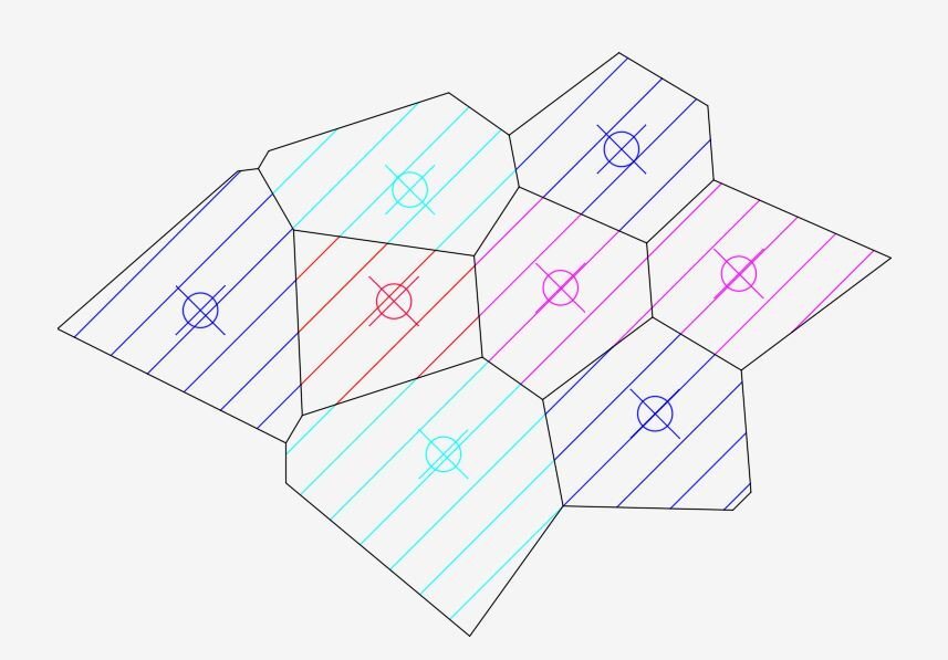

Hello, I am a mining engineer and my task is to calculate the reserves of raw materials in the earth's bowels. The calculation method is with the so-called centroids. I found a Lisp that will help me automatically draw closed polygons (Polyline) around the drilling holes (using the Voronoi method. In the center of each closed polygon there is a point (Drilling) (AutoCAD Point) with a certain color. I am looking for a Lisp that will make Hatch in all closed polygons based on the color of the point that is located in the center of each of them.

5 hours ago, GLAVCVS said:
Is each perimeter made up of a single polyline?
Well.
I guess it doesn't matter.
I said this because the 'boundary' command or its analogue 'bpoly' suffer when the drawing is complex.
Here is another one that might be useful to you.

Of course: you will have to change, in the code, "SOLID" with the name of any other hatch pattern you want to use.
And if you want it to only select the points of a specific layer, change the '*' that appears in '...(8 . "*")' to the name of the desired layer, '(8 . " NameLayer1")', for example
Edited by GLAVCVS
Here is another way if they are just lines
