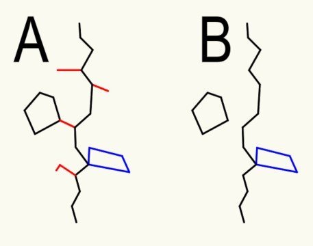

Anders M Posted February 12, 2025 Author Posted February 12, 2025 1 hour ago, Tharwat said: Are you referring to line objects or more like polylines? 6 hours ago, Jonathan Handojo said: What about if the line is partially overlapped? It is a enormous file of 'AI' generated contor lines, created from a LIDAR (I think) scanning, covering the entire county. It contains thousands of double lines, where the AI decided to create a 'spike' of two overlapping lines instead of 'zic-zac' and, sometimes creating a 'handle' to a nearby cluster instead of making them an 'island' as intended. I have no access to the 'raw' data to make lines of my own, and no clue who made it, so I have to try to handle them as they are. The attached sketch shows those double lines as red in 'A' and how I want it to be in 'B'. (In reality they are all black). They are all basic autocad 'lines', no polylines, and they cover eachother totally. I'd like a LISP that either selects them, puts them in a new layer, or deletes them. (There are allso 'loops' (the blue ones) but they are not double lines, so I have to deal with them later.... ) Best regards Anders Quote
GLAVCVS Posted February 12, 2025 Posted February 12, 2025 Those blue loops are what we technically call 'estrangulaciones' here. These are enclosures that contact other enclosures at only 1 point. The rule says that if they do not contact another enclosure at more than 1 point, they must be completely separated (1 centimeter, for example). So when you deal with them, you will do this. Do I understand correctly? Quote
GLAVCVS Posted February 12, 2025 Posted February 12, 2025 As for the duplicate lines, my approach would be to do a full scan of the entire drawing and respect only the lines that coincide at both ends with two different lines Running a code like this on a large drawing like yours would be to put it into operation and take 5 minutes (or more) to buy that coffee for whoever wrote the code That said: when you finished drinking your coffee, the work would be done Quote

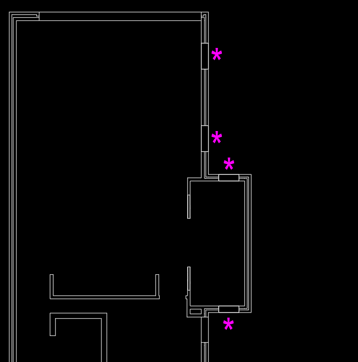

masterfal Posted February 13, 2025 Posted February 13, 2025 I can never get overkill to remove all the lines i need it too. i've attached an example of a drawings which has overlapping lines which remain after running overkill. never understood why they don't get removed with overkill Is there any better way of removing overlapping lines? OVERLAPPING LINES.dwg Quote

GLAVCVS Posted February 13, 2025 Posted February 13, 2025 22 hours ago, GLAVCVS said: As for the duplicate lines, my approach would be to do a full scan of the entire drawing and respect only the lines that coincide at both ends with two different lines Running a code like this on a large drawing like yours would be to put it into operation and take 5 minutes (or more) to buy that coffee for whoever wrote the code That said: when you finished drinking your coffee, the work would be done @Anders M If my interpretation is correct, this means that if, in any case, there are segments similar to the red ones but they are not duplicated, you should also delete them. Quote

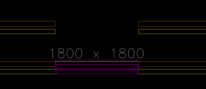

BIGAL Posted February 13, 2025 Posted February 13, 2025 Just a comment when inserting windows using software I have the wall is broken and capped, so there is no line under the window. Maybe look at how your drawing the window. Quote
