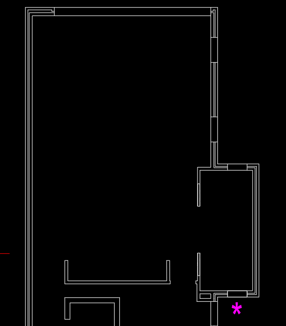

99% of the time i'm tidying up clients drawings to use with our drawings so i'm not actually drawing any of these windows
can anyone explain why overkill isn't removing all my overlapping lines though? its supposed to yeh? does overkill actually just not work properly? or does it work correctly, only removing exact duplicate lines?

i tried this out. it removed the duplicates from 3 of the 4 windows. don't understand why it wouldn't remove duplicates from that last window though..

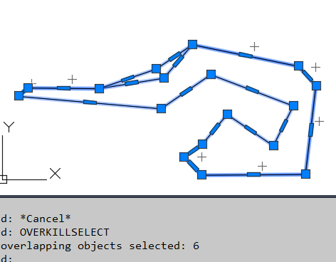

This Must Do It...
(defun c:OVERKILLSELECT (/ ss1 ent1 ent2 lst1 lst2 overlap obj selset)
  (setq ss1 (ssget "_X" '((0 . "LINE,LWPOLYLINE,POLYLINE,ARC")))) ; Select all lines, polylines, arcs globally

Also Extended it to work with...Lines, Polylines and ARCs

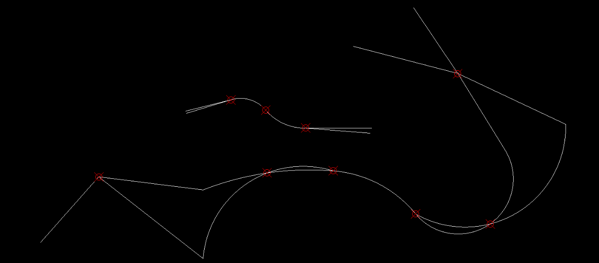

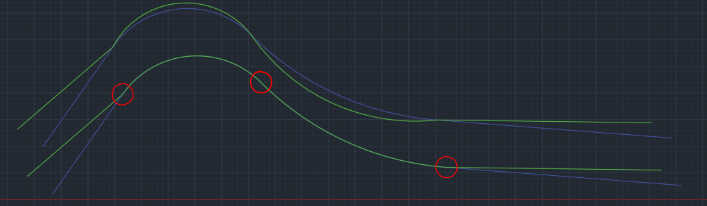

Not quite with polylines... It thinks all of the below are overlapping... you're just checking the end points and not all the points along the polyline
(polylines are tricky, if you want exact then use massoc LISP to return a list of points for the 2 lines, compare the number of points and if equal use member for each point on the reference line to check it is in the compared line.... trickier again when overlapping polyline segments might have different intermediate points for the same shape)
Then there's polyline bulges
CurveCurveInt3d seems to correctly identify bulges that overlap

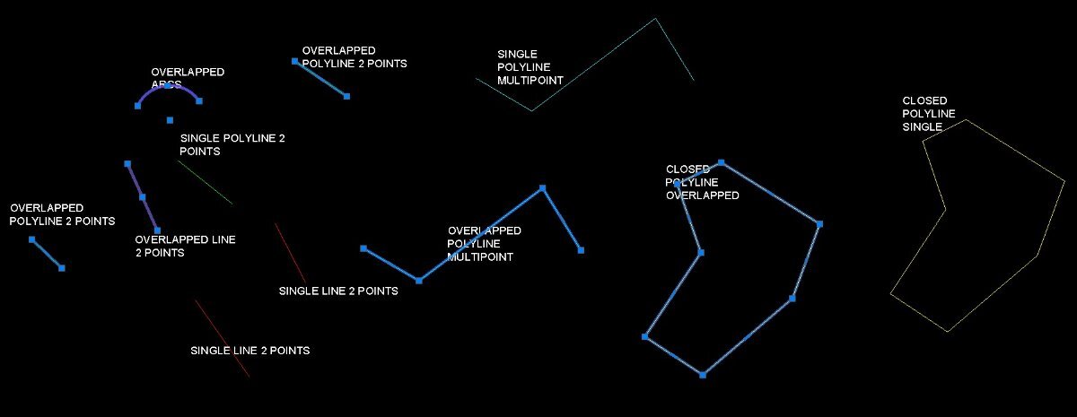

I Just Extended to select the Overlapping Lines, Polylines, Closed Polylines & Arcs.
i Dont See a Problem with the same. it is working Perfectly. and what i understood from the OP's Requirement.

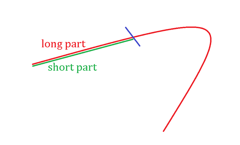

Maybe it's just a matter of adding a function that filters out the polylines selected by the current code.
1 hour ago, GLAVCVS said:
Tal vez sea solo cuestión de agregar una función que filtre las polilíneas seleccionadas por el código actual.
@CADSURAY
But no.
I've taken a look at your code and I see things that are not right.

1 hour ago, Danielm103 said:
@CADSURAY try this drawing
i see what you were pointing at Danielm103....
the best i think is to mark the overlapping portions with points for now whit this code...
Trying to Trace the Path of the Overlaping portion with a new polyline would be more like it...
