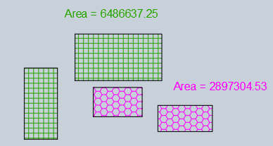

Hi, I need help with lisp code and I would be very grateful if you could give me a solution. I have a cross section and  I want to find the total sum of each layer's total hatch area values and write the result on the drawing. For example at "wearing" layer there are 6 hatched objects and I want to find the total sum of hatched objects at wearing layer . And similar calculation on binder, bitumen ,base and subbase layers.
I have a code and it works without diffent layer condition , I need to insert  the layer condition
defun C:h11 () (hatcharea))

(defun hatcharea (/ ss area i eo pt lst layer lstLayers)

In the initial version, the text has the current layer, but it is necessary that the text layer corresponds
to the hatching layer. After changing the lines in the code, when inserting text, the name of the album of colors is requested...

Unfortunately
Insertion point for area HATCHs in layer '0'; error: Setting the AutoCAD variable is rejected: "CLAYER" ("0" 1.44904e+06)

(defun c:hatcharea-GL1 (/ ss area i eo pt lst layer lstLayers color)

	   (vla-put-layer (vlax-ename->vla-object (entlast)) (car layer))
	   (if color
	     (vla-put-color (vlax-ename->vla-object (entlast)) color)
Edited by GLAVCVS

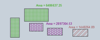

Something else needs to be changed so that other texts have their own layer...

16 minutes ago, GLAVCVS said:
I edited something at the last minute.
You may need to copy the code again
Everything is perfect now!
It wasn't that easy! Thank you many times!
