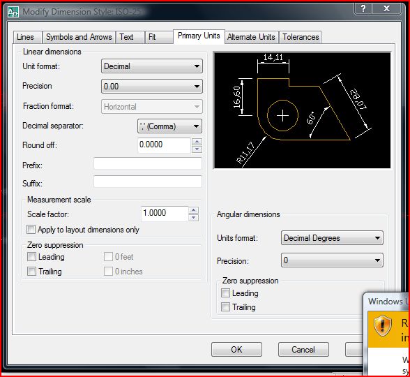

The dimension rounding off is in thousands every time I urn the trailing zero compression off. I try to set it to 0.00 however it returns to 0.0000 mucking up my dimensions.
How do I get it to set at 0.00? Is there something I am missing here?

You can't change the "Round Off" setting to display as 0.00. It will always display with 4 places after the decimal, even if you type in 0.1, it will still display as 0.1000. It's just the way it displays.
I'm not sure how that's mucking up your dimensions? :unsure:
Also, there is no need to change your UNITS setting. Just set your dimension style "Precision" to 0.00 and you should be good to go.
