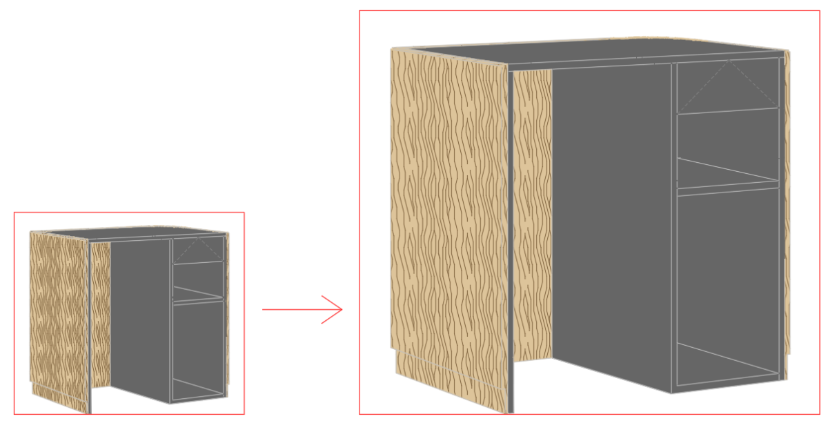

but I think there was a misunderstanding with my topic.
With the example of the attached image I hope to be more understandable.
I have a viewport (in red on left) with the view of an object inside (with a annoscale that is not necessarily defined), with a kind of scale command I need that by scaling the viewport the view internally also scales by the same scale factor (example on the right).

So sounds like scale doesn't really matter you just want it to look the same ratio. Have a command that takes the outline of the view port and puts it into model space. So once you are done scaling the view port to the new size you would then zoom window and pick that outline.

Like I said this creates a viewport outline in model space.  for each view port on the tab its run on.
so to do what you are asking
  • run VP2M
  • resize the viewport
  • then use @Steven P's lisp or zoom window command.

Thank you all,
I solved the dilemma with Named Views. This will set the viewport to the correct view no matter the size/scale of the VP.
