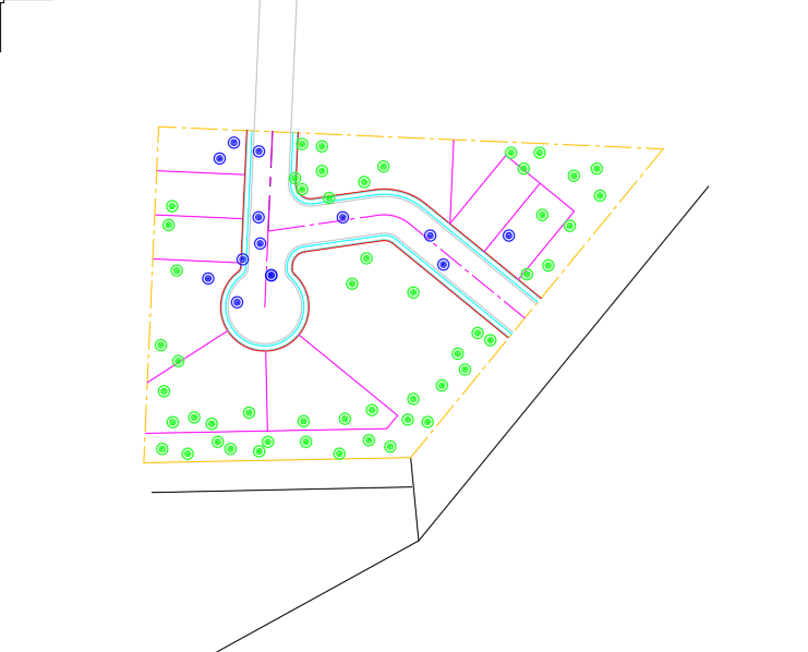

I'm working on Penn Foster's, I see, infamous Oleson Subdivision project which is the final project for Advanced AutoCAD Software Functions.  There are 13 trees of one type I need to insert and 52 of another.
Am I really expected to type coordinates for all these trees and then somehow number them?  If anyone knows any info about this please reply.  Thanks for reading.  :)

Thanks, tombu.   Yeah I'm in the Drafting diploma program and what we're doing is 2D.  I just made an array of each group of trees on their own layer (as per the instructions--not the array part of course--instructions is a STRONG word when it comes to this program) and then copied and pasted the coordinates for each, one by one.  Took a little time but worked fine.  If you know an easier way to do that under THOSE circumstances, DO let me know please.  Thanks for your thoughtful response.

forgot screenshot

BIGAL, thanks for responding.  I didn't do it as deftly as you suggested (I hadn't seen this yet).  But I did just get over myself and make a array and I had the instruction table on my left screen, so I did just move-grab-copy-pasted and all 65 went in pretty easily.  I'm a footer too btw.  Southern MN.  Thanks!
