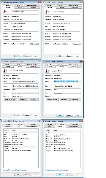

ksperopoulos Posted April 20, 2009 Author Posted April 20, 2009 After I submitted a support request to Autodesk, they gave a suggestion to load AutoCad 2010 from the start menu and also from the "C:\Program Files\AutoCAD 2010" folder to see if I got the same delays. I got the same delays from the start menu that I got from the icon on the desktop. But the acad.exe file under the "Program Files" folder loads perfectly. I looked into the properties for the icon on the desktop and compared it to the acad.exe file under the "Program Files" folder. The attached is what I found with the icon one on the left and the .exe file under the folder on the right. Why would these install differently? Quote
rkent Posted April 20, 2009 Posted April 20, 2009 After I submitted a support request to Autodesk, they gave a suggestion to load AutoCad 2010 from the start menu and also from the "C:\Program Files\AutoCAD 2010" folder to see if I got the same delays. I got the same delays from the start menu that I got from the icon on the desktop. But the acad.exe file under the "Program Files" folder loads perfectly. I looked into the properties for the icon on the desktop and compared it to the acad.exe file under the "Program Files" folder. The attached is what I found with the icon one on the left and the .exe file under the folder on the right. Why would these install differently? The file in Program Files is the actual exe file, the start menu and the desktop are both shortcuts with extras added on. I can't read your images as the resolution is too small to be useful. So, pretty much as I said before, once you have autocad up properly, set it up the way you want it and export, import a profile name and add that name to the desktop shortcut. /p profilename on the target line. Quote
