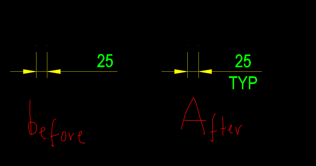

hello all:
I need a routine that first asks me to enter "a word"
and this word is added to the value of the dimension below the line
example
The modified dimension shows this
Does anyone know of any code that can help me?
thanks
Here's a quick one -
(defun c:dimsub ( / enx grp idx new pos sel str )
    (cond
        (   (= "" (setq str (getstring t "\nSpecify string: "))))
        (   (setq sel (ssget "_:L" '((0 . "*DIMENSION"))))
            (repeat (setq idx (sslength sel))
                (setq idx (1- idx)
                      enx (entget (ssname sel idx))
                      grp (assoc 1 enx)
                (if (setq pos (vl-string-search "\\X" (cdr grp)))
                    (setq new (cons 1 (strcat (substr (cdr grp) 1 pos) "\\X" str)))
                    (setq new (cons 1 (strcat "<>\\X" str)))
                (entmod (subst new grp enx))

i will try master thanks
EXCELLENT...
You can make it so that by default it suggests the word "typ" so that with just one enter I can continue the routine and if in the future I need to add another word I can change it.
For a "fixed" default, you can use something like the following:
    (if (= "" (setq str (getstring t "\nSpecify string <TYP>: ")))
        (setq str "TYP")
    (if (setq sel (ssget "_:L" '((0 . "*DIMENSION"))))
            (setq idx (1- idx)
                  grp (assoc 1 enx)
For a "dynamic" default, you can use one of the methods I describe here.
  • Thanks 1
