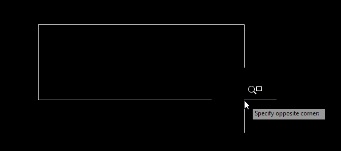

(setq pt1 (getpoint "Pick zoom window first corner: "))
(setq pt2 (getpoint "Pick zoom window second corner: "))
(vl-cmdf "_.Zoom" "w" pt1 pt2)
As you are picking the second point, is there a way to show the dragged rectangle like the normal zoom window command shown below?
(Need the 2 points coordinates for later calculation)
for example:
(setq pt2 (getcorner pt1 "Pick zoom window second corner: "))
  • Thanks 1
Very Good !
Thank you .... worked perfectly.
