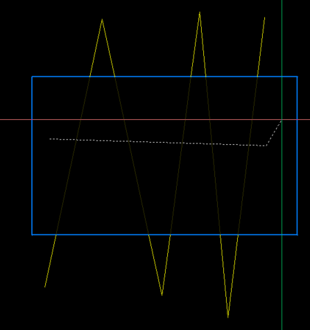

in a different issue, when I ( the user) clicks on the contour, the contours trims fine once then the building no longer selected, so if there are more than one contour inside the building the rest of them cannot be trimmed unless you run the lisp again until all the contours are trimmed, any idea how to keep the building selected until the user hits enter?

I would look at using "fence" in the trim can select multiple crossing lines.
