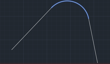

Danielm103 Posted March 12, 2025 Posted March 12, 2025 Not sure with Lisp, with ARX, you can highlight sub entities, here’s a sample in Python import traceback from pyrx import Rx, Ge, Gi, Db, Ap, Ed @Ap.Command("doit") def justDoit(): try: # selet a polyline ps, id, pkpnt = Ed.Editor.entSel("\nSelect", Db.Polyline.desc()) if ps != Ed.PromptStatus.eOk: raise RuntimeError("Selection Error! {}: ".format(ps)) # open the polyline and get the closest from pkpnt pline = Db.Polyline(id) cp = pline.getClosestPointTo(pkpnt) # hack out a gs marker for the segment and create a path gsmkr = int(pline.getParamAtPoint(cp) + 1) spath = Db.FullSubentPath(id, Db.SubentType.kEdgeSubentType, gsmkr) # highlight is ok with kForRead pline.highlight(spath, False) except Exception as err: traceback.print_exception(err) Quote

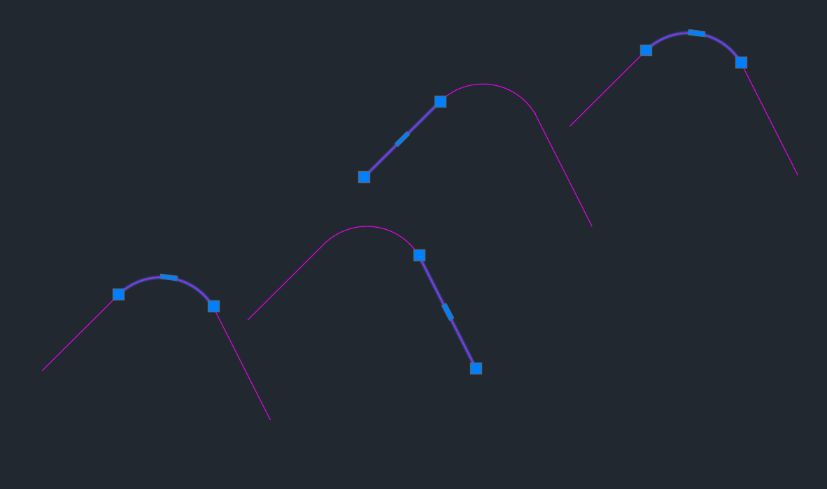

Saxlle Posted March 13, 2025 Posted March 13, 2025 On 11/03/2025 at 14:52, Gino Lau said: I was trying to use LISP to select a segment or edge of a polyline, using "entsel". But when my mouse hover to an edge, it select the whole polyline. If you want to select just a single or multiple segments of polyline, you can use CTRL + mouse left click to select segments of polylines (I don't know what do you want to accomplish with lisp). See the attached picture. Quote
